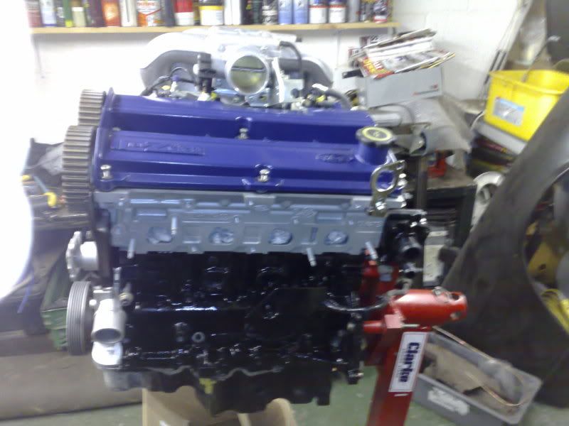

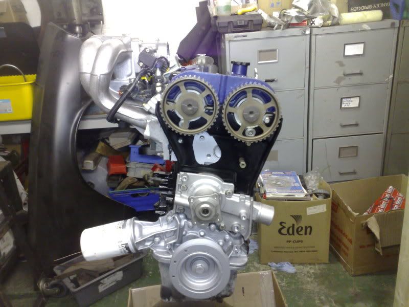

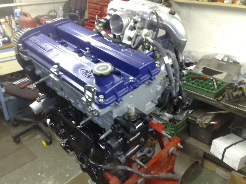

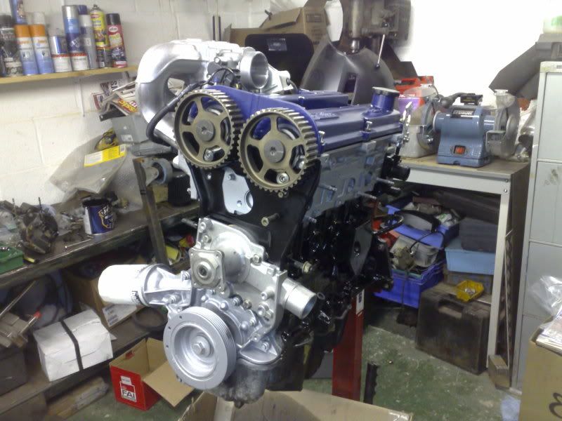

I havent been out in the garage for a session in a while due to work commitments :x (although I cant play with out work!) however this weekend has seen the engine pretty much painted, re-gasketed :doh: , and various other bits done. After spending a good day on it and repairing my mates mk2 esccy I was tired and clumsy enough to drop a bolt and washer into a cylinder at which point I was headbutting walls :doh: . Eventually after a major headache and some clever farting abouting I got them out! Anyways heres some pics so far, still more bling to go on the engine tho :thumbsup:
COMMENTS! :D
'Sideways Always'
 Post subject: Re: My 2.0l conversion
PostPosted: Sun Nov 23, 2008 7:59 pm
Joined: Sat Jul 26, 2008 7:33 pm
Posts: 148
P.s. Please excuse the sump (still waiting to find one) oh and the cambelt is done.
'Sideways Always'
PostPosted: Sun Nov 23, 2008 8:37 pm
looks pretty damn clean buddy :thumbsup:
what oil filter is that?
PostPosted: Sun Nov 23, 2008 8:58 pm
Posts: 148
O its just the old mondy one, I have put a new filter on it from the 1.4si which is shorter, I forgot to mention these pics were taken a bit early really as I had not completely finished it :doh:
