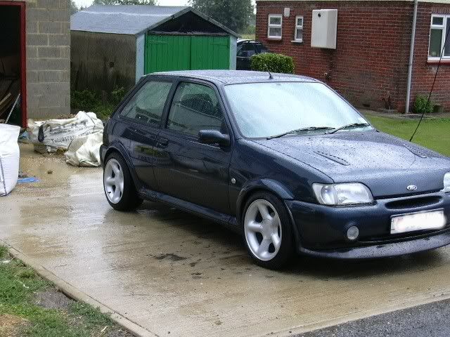

allegedy mines a 35 drop and the archwork is enough for that if you really really wanted to do a 60mm drop on propper cossie wheels and use a tyre thats not dangerously stretched....youll have to basically build your own semi wide arch kit.....or stretch and remake the wings in the right places...not a 5 min job
remember anything under a 205 on an 8 inch rim is getting on for badly stretched bordering on dangerous anyways...most peeps go for a 215/40 tyre...215/35's are avail but do cost!
cossie wheels are monsters...worth the work...but the amount you'd have to do to accomodate them on a 60mm drop in my opinion is not worth it..not that it cant be done...but if your gonna do it...dont have a budget..and dont expect it to be cheap!
i take it you do mean the ones with the dimensions 8x16 ET25 ?

That car is GORGEOUS!!!!
Always liked it Image
PostPosted: Thu Apr 19, 2007 6:59 pm
i was trying not to put a pic of my car up..but i needed to....to illustrate!.....
besides...its looking a lil diff now sooooo!

*droool*
damn you and your cossy rims mate.. they look awsome!
