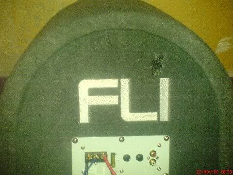

there are no lights on it....so am not even sure if the amp is on...

my mate had one.
they have a blue led which lights up when they are on obviously.
my mates unit was nadged after a couple of uses - not even pushing it.
i dont rate their build quality - he had to return his because we couldnt cure it, and then get a replacement unit. nice. :lol:

well, no, i dont think you catch my drift, they sound good and dont look too bad, but they are built like a boy scouts raft!
try running a short piece of wire between your constant +12v (big red wire from battery), and the remote terminal on the amp (just a short jumper wire), if it lights up you know you've put your remote wire to the wrong terminal on the back of your headunit..
