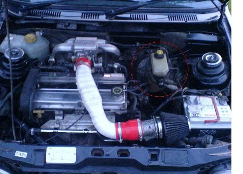

I was really looking for a quick and easy method for checking for the ABS. As I will likely be telling them over the phone. My main thought was an ABS light on the dash?
PostPosted: Wed Sep 27, 2006 3:52 pm
look under the bonnet and at the brake servo (big black round disc thing circled red in pic below) if its got green metal pipes coming of it has got ABS and vice-versa!
like mine below dosen't have ABS.
