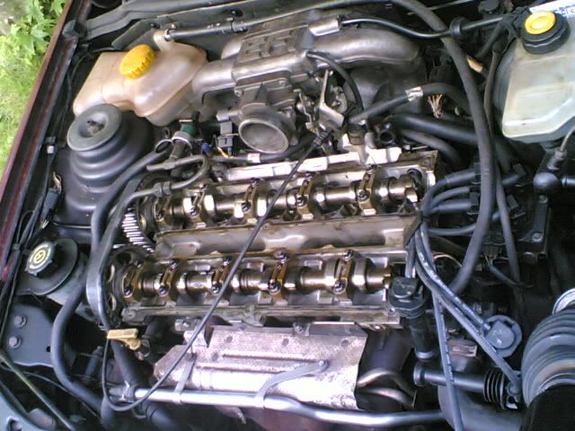

and the wing as everyone else has already said just by a new one as it will be to much hassle to get of..if you do go with that one tho...open the bonnet and you will see where the wing connects there will be bits that are alittle thicker than the rest shouls be about 6 and a line of three at the very top...drill a 9mm hole through the middle of them and it should get the tacks of once you have done that just behind the side repeater are two bolts attaching it by the door apart front that just the seam underneath then...i would seriously spend dat bit extra and get a new as your likly to bend it as it comes off round me they are only about £16 so might aswell
have a look at this pic if you look close u can just about see the tacks on the wing...sorry only one ive got showing the wing.lol
