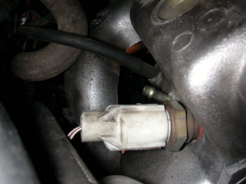

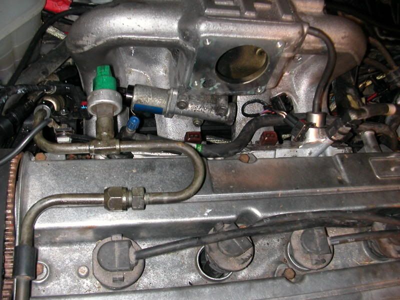

Here are the injector things, what plugs to them, what wires?
Also cant find this vacum tube that goes here, any ideas where it comes from?

there's a subloom that attaches to the bottom of the inlet manifold. it plugs in just above the fuel line connections
vacuum hose fitting is either pulse air system, of return form solenoid on charcoal cannister.
water pipes, expansion tank goes to rad.
the water rail is fed from the hose that comes off the pump and splits twice.
will find out the wire colours for ya tommorow for you injectors, but you'll find they'll pretty much fall into place due to years of being there.
only one's you've gotta watch are injector 1 and iscv, and injector 4 and cam position sensor, you dont wanna be mixing them up
the round plug sounds like inlet air temp sensor, i think it's on the subloom mentioned above
think thats everything
any problems i'm happy to help
JJ
