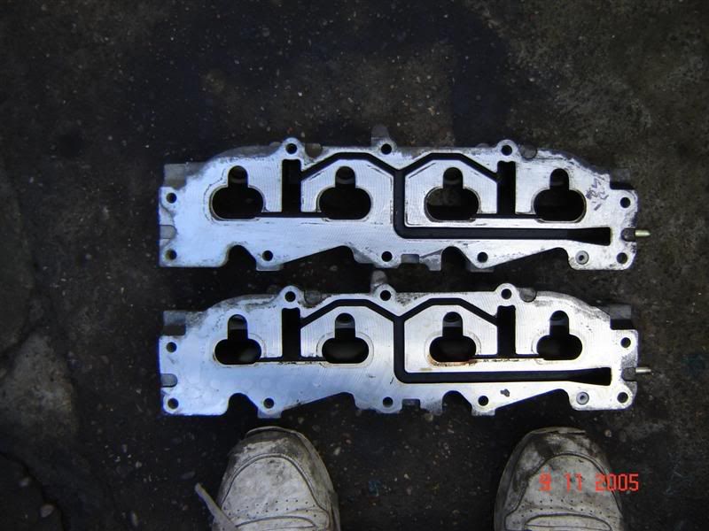

this pic highlights the diff between normal 1.8 at the bottom and the 130 spec one at the top.....the manifolds are pretty much the same...difference being the Throttle body and the sandwich plate....
throttle body increased to 54mm and the sandwich plate image is below
