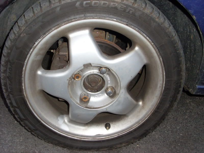

bought new wheel nuts when i bought my rs rims, as my old ones were too small.
chaps at my garage told me the ones i have are going to bugger my wheels eg eat through them because theyre too small at the bottom or something like that (cant remember the exact words)
anyone know which i need now? he showed me but ebay all seem to have the same so not sure if they have a diff name? not just plain pld steel wheel nuts?
want to get this sorted before FF so i dont kill myself and my girlfriend on the way there.
thanks

Im gonna guess the rs2000 wheels are the same nut as the gti wheels as they are both off the same model of escort so they should be tapered with open end. If you go to a motor factor and ask for ford alloy wheel nuts that is what you will get. Garage is probably telling you from an "iv never owned a ford" sort of view.
Just take a look at the wheel and see what will fit.

so you have these wheels
http://img.photobucket.com/albums/0803/ ... 381872.jpg
the wheel nuts you need are these
or these
both will work fine, any scrapyard usually have them for £10 for 16 :)
the wheel nuts you put in your 1st link are for mk1/2 escort rs2000 wheels, thats what confused me lol

PostPosted: Wed Aug 03, 2011 10:11 pm
wheel nuts arrived today... can see the difference between the two and how the shitty ones can affect the wheel!
thanks to everyone for the advice etc!
