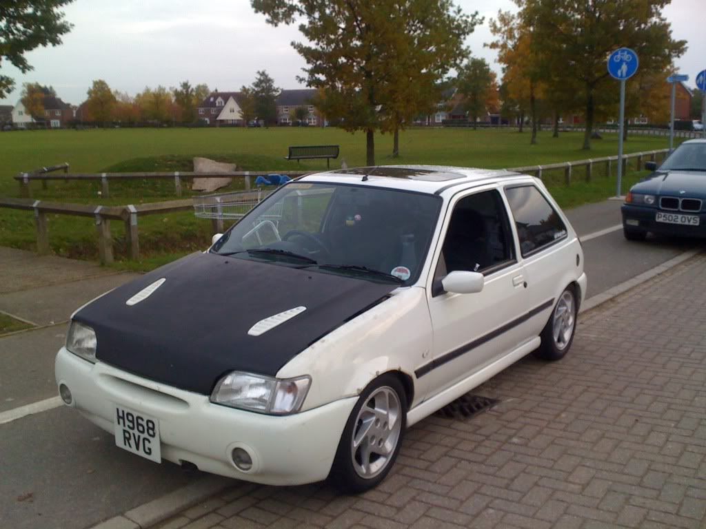

I have a strange problem with my lights on my fiesta. i have working sidelights and full beam, just my dipped beam doesnt work and i need them to work to pass the mot :( i have checked the bulbs and there fine, i checked the fuses and there also fine, someone told me to change the light stalk switch thing so i changed that (twice) and that didnt work, i then cleaned up the earths for the lights and still i have no dipped beams. i dont no if im being stupid and its somthing easy or if its just a general problem with these cars. The only other thing i can think of is the wiring but i have no idea were to start. im sure i cant be the only person with a mk3 fiesta who has had this problem so hopefully someone on here can help :D
Thanks Dan
