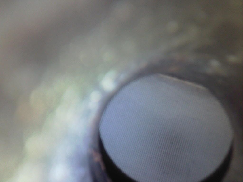

saying its knackered just by banging it seems a bit crude, if he had it on a ramp it would only took 5mins to pull the exhaust of the back of the cat shine a torch up it and have a look, should be able to see the matrix like this
Will
PostPosted: Sun Oct 17, 2010 12:56 pm
Posts: 877
Hmmm, never found that info anywhere about what it looks like doing that. Might have a look myself.
