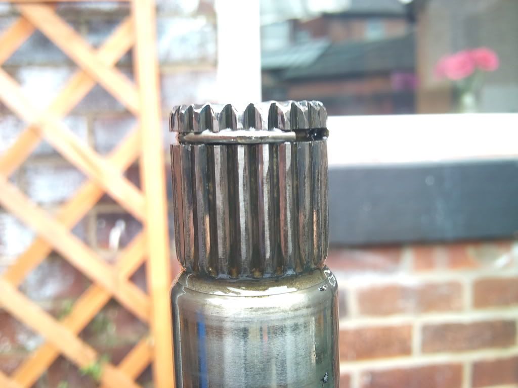

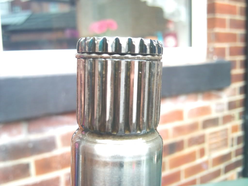

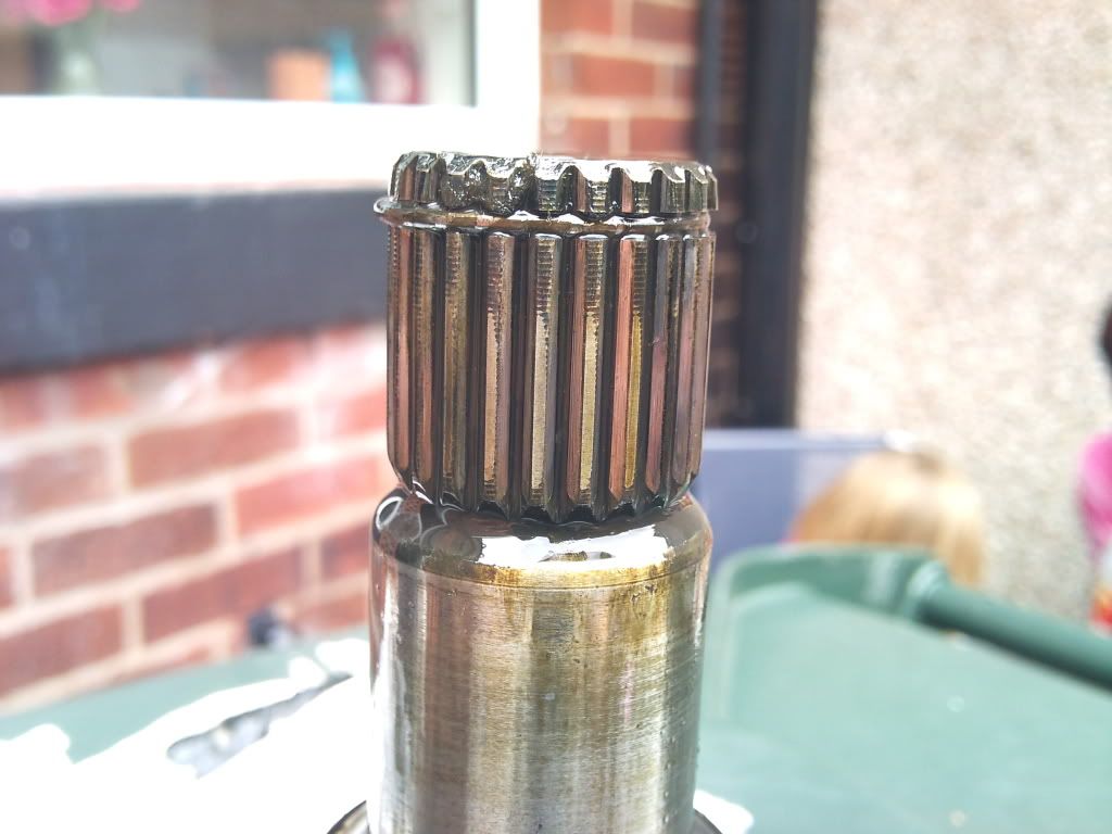

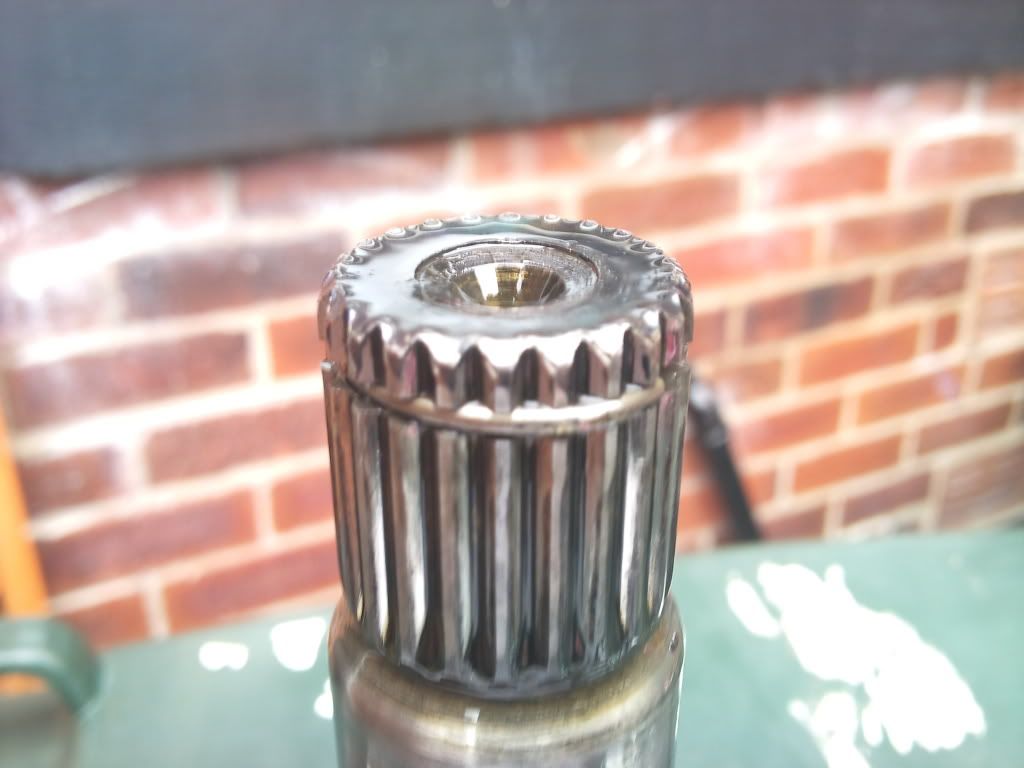

Well its a peiceful sunday so i thought i would get to the bottom of this, as iv described the noise i hear sounds like the slipping of splines so where would you fined them, in the gearbox so i set about taking a look at the parts that the drive shaft attach to so take a look at these pics and you can see they are worn down, now much but tbh it wouldnt take much really:
the first 3 are the passenger side and the last one is the drivers side, the drivers side doesnt look as bad but thats the one that hasnt had the drive shaft changed so that will need changing and hopefully problem solved :wth: so long as this gearbox doesnt get ruined because of it. Has anyone of you guys ever suffered this problem as this it just seems to be me lol? :doh:

the splines are fine there aint a problem there of what i can see. how is the clutch cable and pedal. i no it seems weird but it could be something around that area if youve changed the box and shafts.

them splines do look good bud :doh:
check the splines in the cv joints :thumbsup:
i realy think thats where the issu is

yh could well be. clean up the grease on the inside of the cv boots and look at the roller bearings. see if there is an loose or dont spin round nice and freely. have you checked for any play at your wheel.
