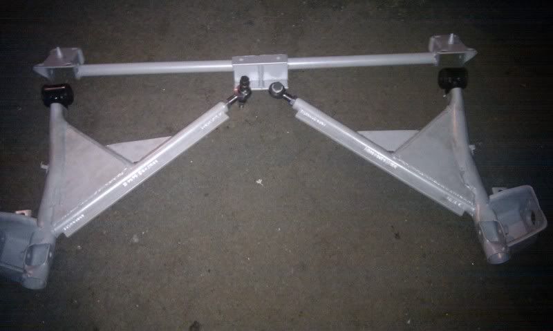

PostPosted: Tue Aug 03, 2010 11:32 pm
they are 650 (or there abouts) guys name andrew. and normally goes under the alias freak-power :)
PostPosted: Wed Aug 04, 2010 10:08 am
Shit I thought it was 450 :lol:
Oh yeah. I'm collecting it tomorrow night darling ;)
PostPosted: Fri Aug 06, 2010 7:54 am
Anyways,
I collected the Independant rear beam last night... I got informed that the "freak-power" guy doesnt make them himself, a guy at his work does... and this is his last one as he recently passed away.
Think this is the 8th in existance, and last one.
Enjoy it Jam ;)
PostPosted: Fri Aug 06, 2010 9:22 am
oooh that looks slinky. cant wait till my next visit to the cave.
PostPosted: Fri Aug 06, 2010 1:51 pm
sweeeeeeeeeeeeeeeeeeeeeeet!!!! i love it!!! : and it came from the 5 door i broke up last year not standard now :lol:
