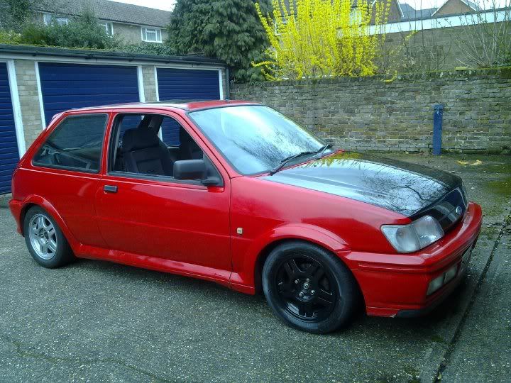

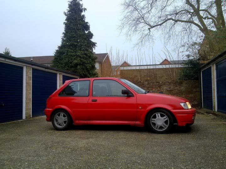

Just for you all to see, this is a pic of the 2i when I picked her up after passing with £400.00
And this is where we are at now...
PostPosted: Fri May 28, 2010 4:06 pm
Not bad for 400, whats the rott like?
PostPosted: Fri May 28, 2010 4:42 pm
Joined: Sun May 23, 2010 8:39 pm
Posts: 5
no rott, fuel cap mint, a tiny bbubble of rust imerging from above the rear arch, the cills and that have been done and are solid.
i thought it was a good buy just gone over 100k on the clock but still pretty average miles for age.
PostPosted: Fri May 28, 2010 5:39 pm
Sounds pretty good, I would still rip out the complete interior and check, as all mk3's are worse than they look lol
