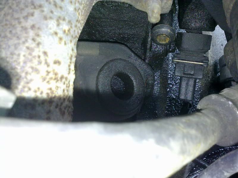

the PCV is in the housing that goes on the front of the block behind the exhaust manifold. the pipe follows the shape of the block round to the gearbox end of the inlet manifold.(right hand as your stood infront of it.) its a push on nipple connection if that helps. if its missing surely its chucking oil out of the hole where it should be?. the idea behind it is that the oil vapour and possibly any oil is directed back into the engine via the inlet manifold and not just deposited on the floor. PCV or positive crankcase ventilation also is there to stop the pistons as they go up and down creating pressure pockets and pushing oil where it shouldnt go. PCV missing shouldnt cause poor starting. unless the pipe is split and its sucking in air or sucking it out of the crankcase. unless its stuck open. its only a low poundage spring and a disc in there so there is very little to go wrong. the compression used for combustion is generated by the pistons which are sealed by the rings but id have thought the tell tale blue haze would give that away. when it starts does it idle perfectly or does it hunt a little to begin with?...burning oil at all?

Here is a picture of what greeted me when I went to look at the PCV to see if the pipe was causing a problem with my idle when warm
As you can see there is no valve in there and it is oily around the area so it has obviously just been venting out there when required !!

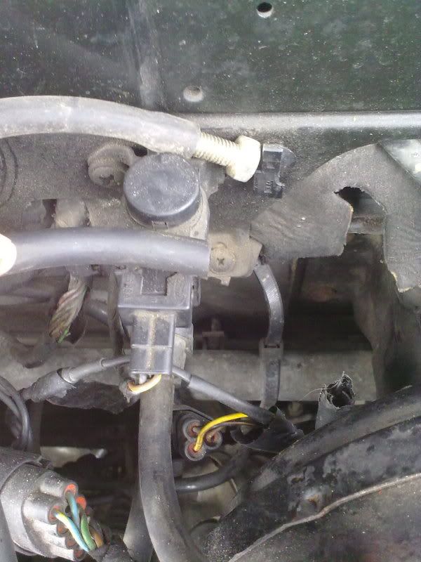

EGR and Pulse Air Systems have also been removed, the picture below shows the top and bottom pipes on the EGR module, the top pipe has a bolt in it to stop any air leaks although the bottom one doesnt, should it or is this ok and not likely to cause any problems

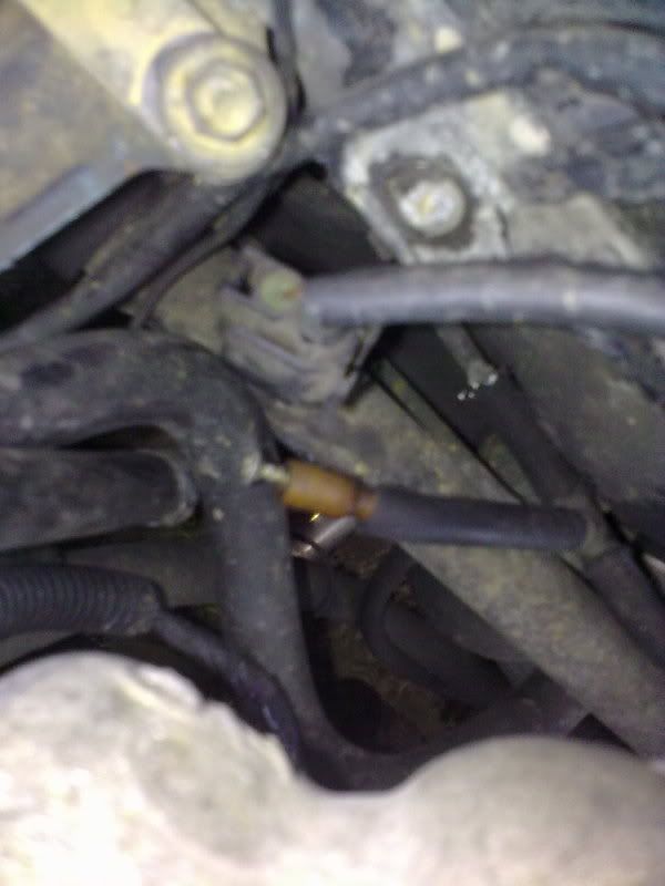

I also found this with another screw in it but I dont know what it should be connected to if anyone could help
