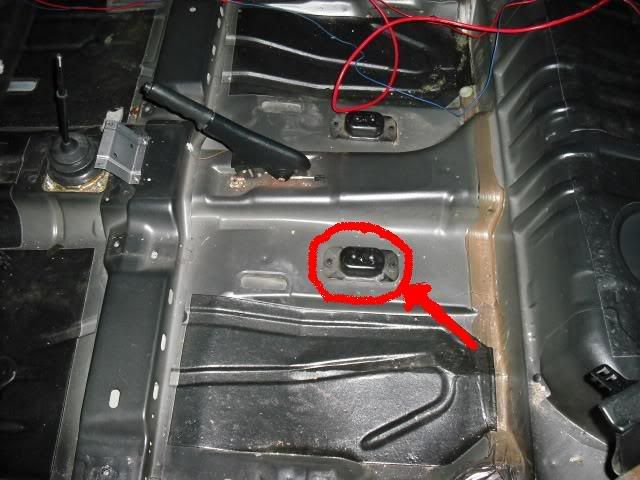

I am in the process of removing a Escort GTi interior from my Si and refitting the original Si wingbacks
I have managed to get three of the 5 bolts aligned and fitted
I am having trouble getting the two rear bolts at the back of the inside runner fitted
I have found and circled the black block in the picture below to show what part I am missing
Can anyone tell me if this can be removed from a Fiesta as if it can I will pop out to the scrapyard tomorrow and remove these parts for my floorpan
It looks as if in the picture above there are two bolts, one either side, that hold the black block to the floor. This black block is completely missing from my Si
Any help much appreciated
Scott

yes as you say it is just bolted to the floor pan with two bolts and the seat runner bolted to it

its called a top hat mk3.5/4 fiesat have them iirc mk6 escorts and early pumas have them

Got some out of a mk4 Fiesta from the scrapyard today and all fitted
No idea why someone would have removed them in the first place but its all sorted now
Another problem fixed !!
