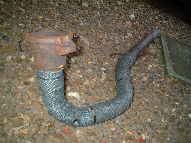

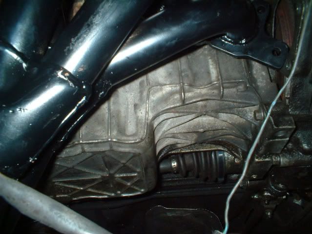

been a while since i last looked at the si manifold and downpipe but should it not bend towards the driver side?
the pics are a bit deceiving in that they appear to show it over to the right when in fact the "1" piece of the pipe is bang in line with the middle of the manifold.

it should go over to the passenger side as the gap in the sump is next to the gearbox, it looks simular to mine, are you expecting it to be a direct fit and connection to your exhaust?
standard De-Cat pipe

yeah that looks right. they are a shit fit as std youll have to adapt your system to fit ;)

well it fits ok (after removing the starter and cooling fan)
problem i now have is i seem to be 8 inch short, the gap is between the 1-section and where the rest of the ashley system starts, anyone know where i can get the missing piece?

thats exactly what it looks like matey!
i thought with me getting the ashley manifold and full system that thats all i'd need, why dont ashley sell the "missing piece"?

i had a similar thing with mine, just had a little sleeve made up at local exhaust place that just slots in to bridge the gap!! think it cost about £20 though.

sounds good, but ive got a stainless system connected to mine not a ashley system
you would think Ashley would make a system that connects, but thats Ashley!! dont expect to much, think they leave the gap as you would always need a flexi joint but dont think they even say that on their web site

mines from a turbo manifold dude so will be different, was just showing the way i got around the pipes not meeting correctly!!
