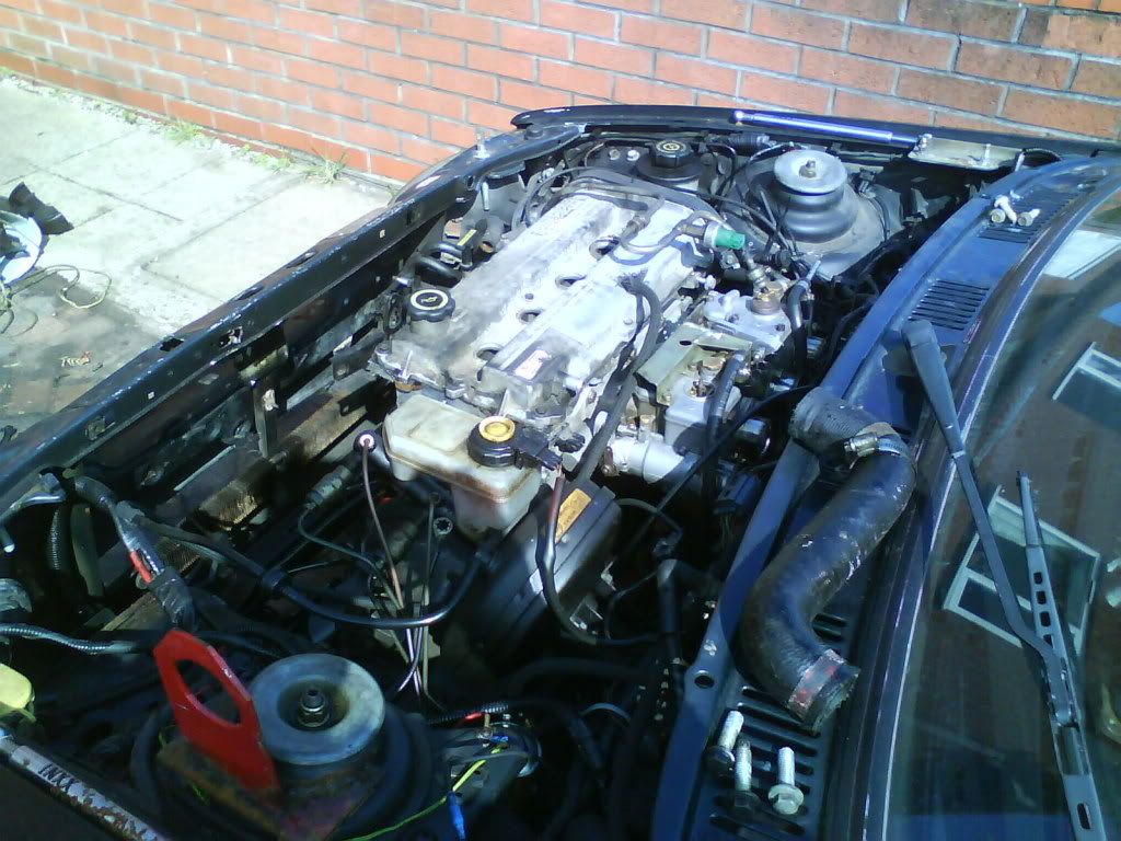

i have 40s on mine mate and it is running standard management and run fine for me its still quick enough for me
and the person who had my car before got 152 bhp aswell so 150 is about right what he said

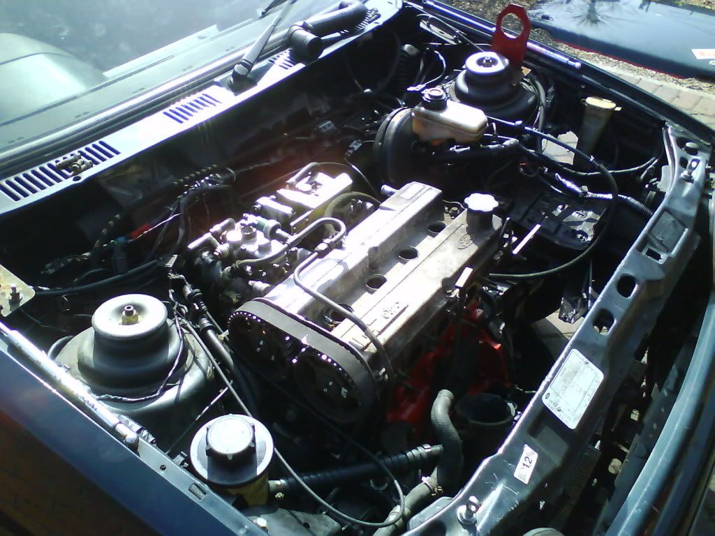

this video running we had just got engine running as i put a new engine in
http://www.youtube.com/watch?v=FykyJZFQ ... annel_page
another one messing around i love carbs for this lol
http://www.youtube.com/watch?v=0FAUh3qK ... annel_page
no idea what jets and chokes it has as i bought the car with them on so no idea i could possibly find out
and pics you dont get much room at all very tight down at the back

kool, thanks for the pics,
