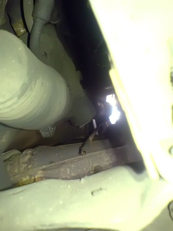

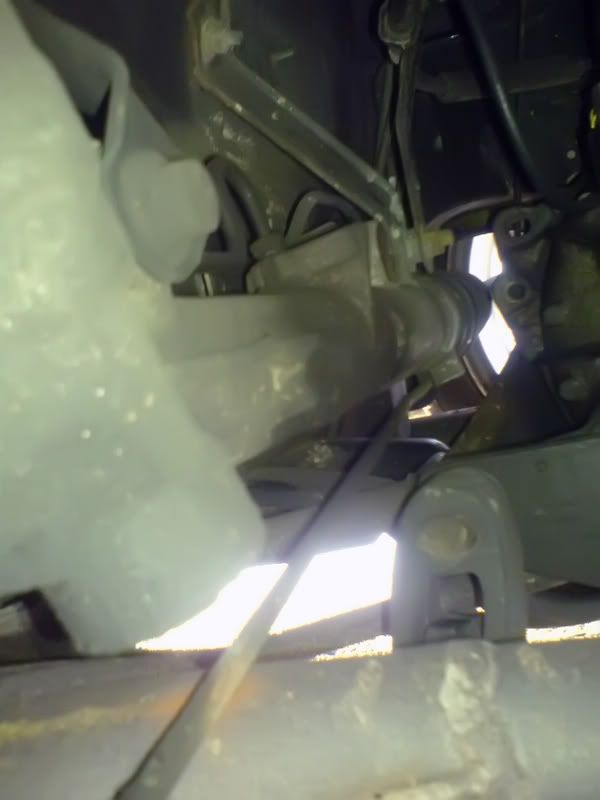

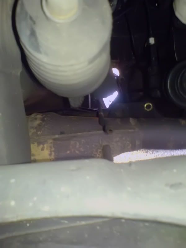

I think i may have found the steering problem...
I havent had alot of free time to jack the car up and take a closer look to see what it is, but can anyone tell me what it is, what it does and if its easy to replace.
Its the little tube type thing thats hanging down and resting on the cat.
PostPosted: Sun Sep 28, 2008 8:31 pm
i have no idea, i would look at mine but it too dark atm, ill look in the morning for you :)
