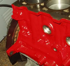

do u need this or is it just to align the 2 parts
also
when u fit a escort zetec gearbox to a mondeo lump there appears to be an extra hole on the gearbox!
pic aint gr8 as i took it wit me phone :)

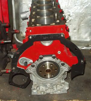

the plate is originally there so best to use it as for the extra hole spose thats normal i have 2 spare on mine

£7.50 i belive from ford the part num is 6051949

Regarding the big hole, this is because the mondy 2.0ltr engine had that different style gearbox on originally, you either leave the hole and risk sh*te getting in there, or make a little plate to cover it :)

will make no difference if you fit it or not is what i found apart from it will keep debris out of the flywheel, on all 3 engines my escort has had not one has had it fitted (i always forget) and i had no problems but if i had rememberd i would of fitted it purely for the simple reason that if theres somewhere where a stone/bit of wood etc could get in then id rather be 100% that it cant get in, mind you i havent taken any of the engines bak out again to fit it so choice is yours.

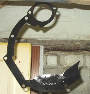

Engine to Gearbox mating plate
This is the standard CVH mating plate. It lines up fine and if you are using an Escort sourced Zetec no modifications are necesary. However, the Mondeo spec 2.0ltr block is slightly different. On the Escort blocks there is a cast in web on the inlet side of the engine that seals against the bell housing.
On the Mondeo, this web is missing so there is an open space as shown above. This needs to be sealed to prevent debri from entering the bell housing and rattling around at the high speed of the flywheel.
Here you can just make out a plate butt welded into place to fill the void.
And now all nice and pretty to match the shiny engine.
