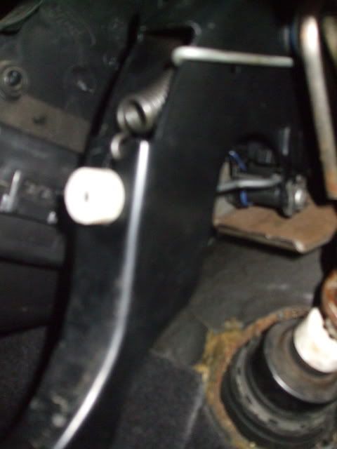

standerd manual will look like this...........
sorry about the blurry pic i was cold lol
if it looks like that then its a simple case of lossening the white screw. then push the white screw in which will realease the rachet clip and you should be able to push the peddle to the floor without any friction, tighten the white screw back up then loosen it of again and pull the peddle up untill its at the right hight(it will click when doing this doe to the rachet) when its at the right hight tighten the white screw back up! job done.
if its not that type then i have no idea!
think ill make a guide on manual adjustment on cluch peddles as i seem to tell everyone :lol:
