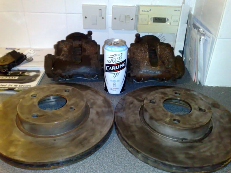

PostPosted: Mon Mar 03, 2008 10:42 pm
right..by the looks of that..those are NOT 4x4 discs have a measure of the disc...at its biggest point..it should be 278...but im guessing that will be 283....look like 2wd discs to be honest...as the offset on 4x4 ones is alot less
did you get those off someone with a mk3 or 4 escort?
as to run them on escorts..thats the setup you'd need
Jam
PostPosted: Mon Mar 03, 2008 10:46 pm

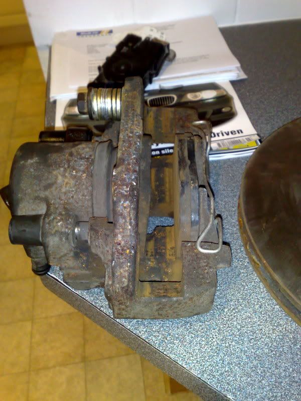

here are pic's of my 4x4 disc's for you as reference
mine dont seem to have such a big lip on them!
