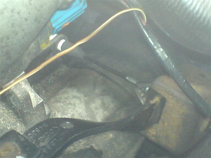

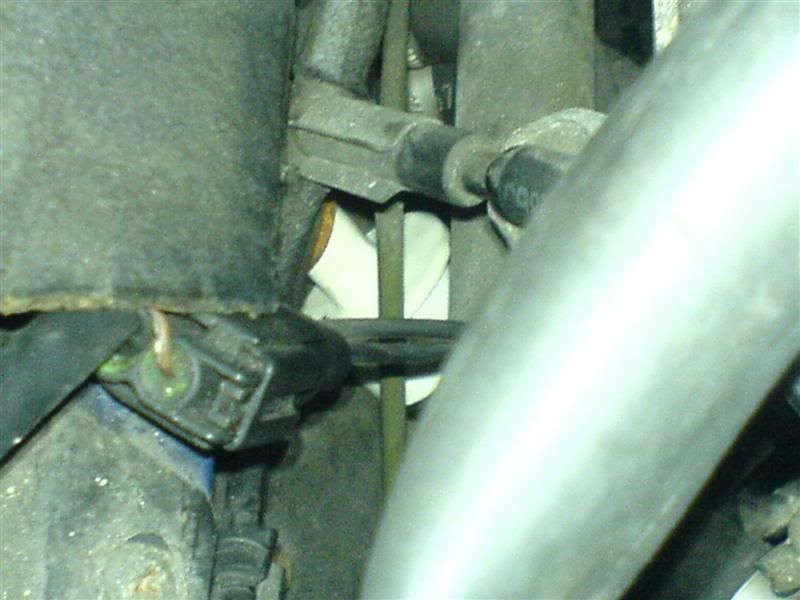

right i didnt find a white screw behind pedal so i adjusted it the other way but even though i have done that it still wont engage gears
here are a few pics and a vid
that is the clutch release arm
this is new clutch cable at bulkhead ( a foam peice was on the old cable but i didnt put it back on should i have it went over the very top of the white part )
