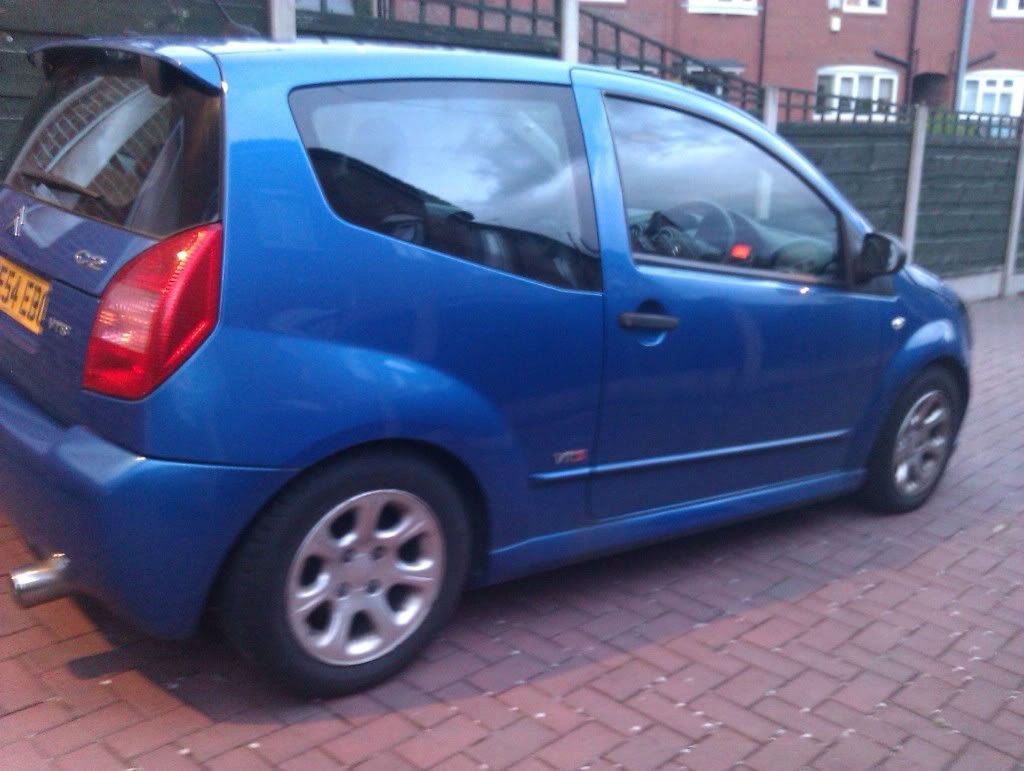

You are correct, I fit wheels from my fiesta onto my saxo and had 20mm hubcentric spacers!.
Proof of concept:
I now run those wheels on the C2 over winter (winter tyres)
