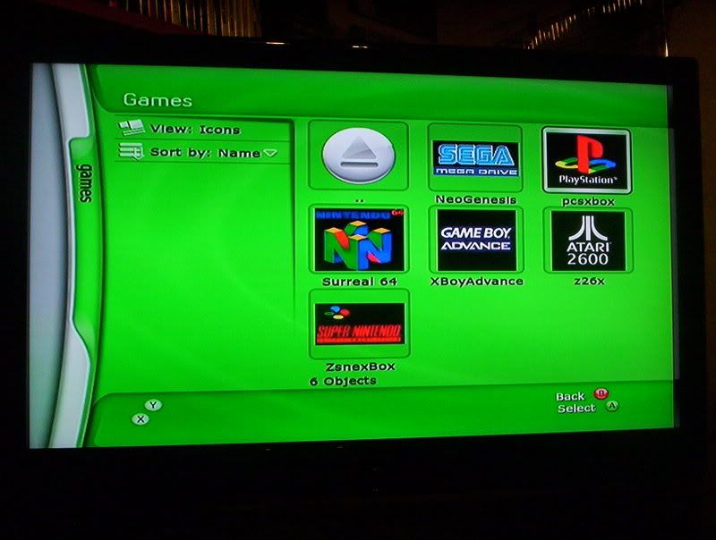

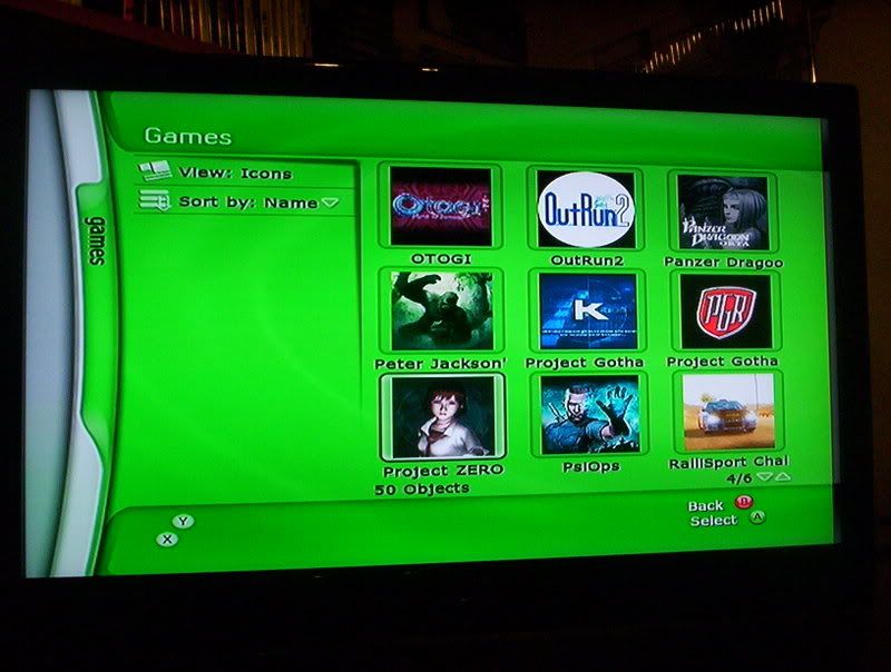

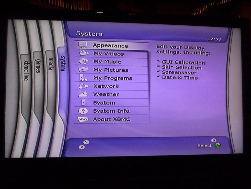

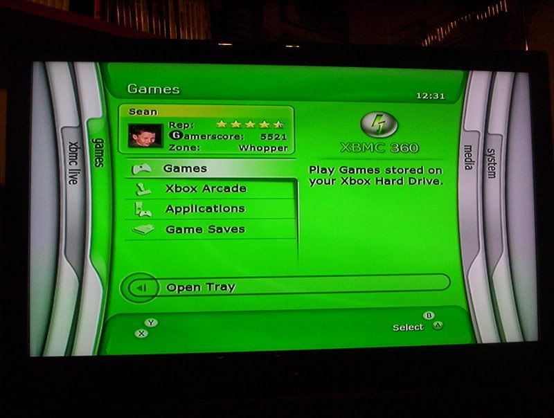

Back with more info:
Firstly this has a 160GB hard drive and a Duox2 Lite chip.
Some screens:
Some nice options
50 games installed

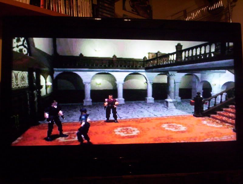

Emulators, Yes they work
I bit of resident Evil on the playstation emulator
The media blade, you can stream pictures, music and videos from a PC or store them on the hard drive.
The movie trailers links into apple trailers and gives you more info along with streaming of trailers instantly
Look and change all sorts of settings here.

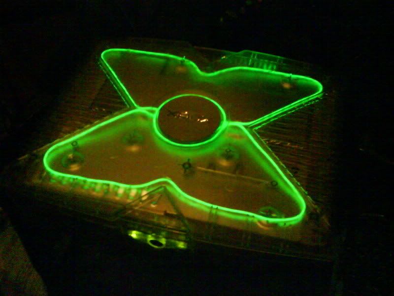

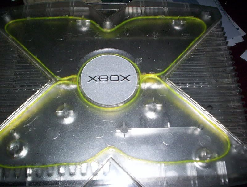

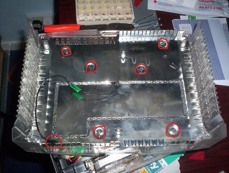

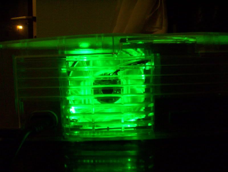

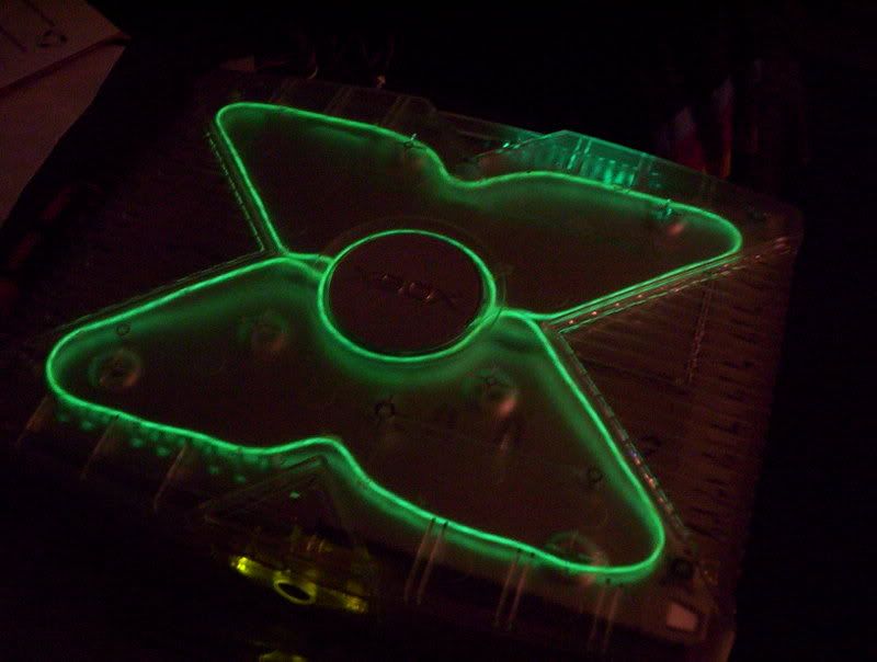

Internally is just a PC El wire kit, it had pass thru molex connections so in the hard drive power line it goes and I mounted the small power invertor behind the dvd rom. From this I attached a plug for the EL wire, also see the 80mm fan fitted with some cutting away of bits.
While the lid is off remove the silver tray from it by bending upwards the griping points circled, one you have done this remove the metal tray. Now route the EL wire where you want it and bluetack it done (I would recommend starting behind the centre jewel), once you are happy with this remove the bluetack a section at a time and glue down (I used a hot glue gun). Make a small hole in the silver tray and feed the power cables back in and attach the opposite plug to the invertor.
The you should have something that looks like this (or whatever design you choose):
Put is back together (remembering to plug it in):
And one of the fan on the back:
It is worth noting that you can change the colour of the power button on the front to always green, orange or red. I think the same mod with red wire and so on would look good. If you want to be really clever you could change the leds in the power button and choose any colour you wish.
You can get replacement cases in many colours too which could be fun.
Hope this helps :)
