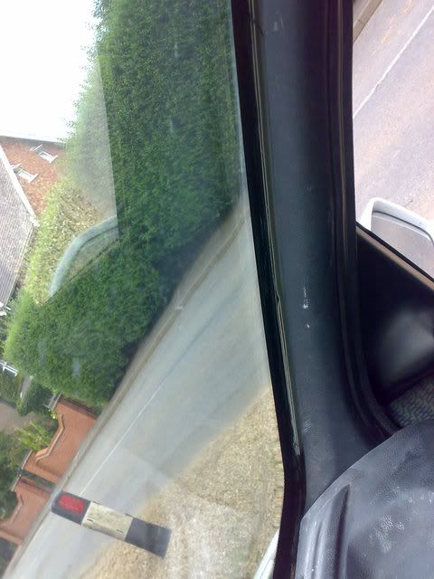

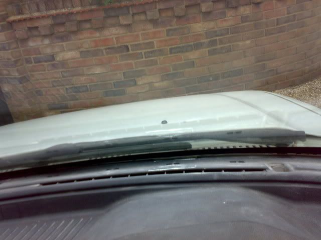

PostPosted: Sat Aug 30, 2008 7:17 pm
Here are a couple of the inside. as you can see you can see the sealant and parts of the metal.. to overcome this if your really bothered.. mk4/5 a pillar covers modded to fit.. and mk4/5 dash.
also top of roof lining you can see, but due to the black edges on the windscreen you cannot see this from the outside.
it doesnt bother me really.

I'm really really sorry for dragging a very very old thread up, but it's worth asking other people if these guys aren't on the forums any more...
Regarding the gap left on the interior, what about using the back half of the windscreen seal fitted in place? Merely as an aesthetic thing? I've attempted to remove a windscreen from a MK3 before in a scrappy, and the easiest way (because the rubber was in worse condition than mine) was to literally cut the outside of it off leaving the inner portion.
PostPosted: Tue Apr 19, 2011 12:35 pm
That would work.
I would do that on the bottom part nearest the dash and use mk4/5 a pillar trims
