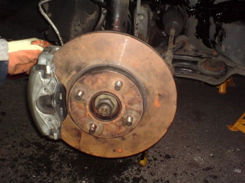

so heres how to fit mk6 fiesta ST150 discs and calipers to your car.
firstly remove the wheel(remembering to undo the bolts before jacking up the car :rolleyes: :lol: )

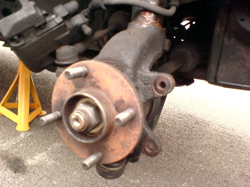

whip off the old calipers and discs,its a case of 2 13mm bolts
(a monkey could do it!)
then go grab your mahoosive ST calipers and discs, and mount them on the hub, they will bolt stright up with the SI caliper bolts(the ST ones are too long)
fit braided brake line while your there perhaps.
bleed it all out
and bobs you mothers second cousin twice removed
refit wheel and repeat for other side and go for a gentle drive to knock the rust off the discs and perhaps bed in new pads if you got them, you might also have to remove wheel weights on the inside of your rims to clear the calipers(i have escort gti wheels on mine and i had no issues with my wheel weights)

I can confirm this guide also applies to the RS2000 260m setup. ;) Everything just swapped over and bolted up, couldn't be simpler.
Useful if your wheels have less clearance.
