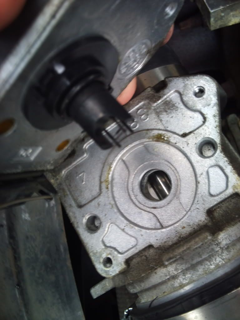

PostPosted: Mon Sep 20, 2010 6:33 pm
since iv one this recently i thought i might aswell post the pic on here for future reference to show these wires :thumbsup:
