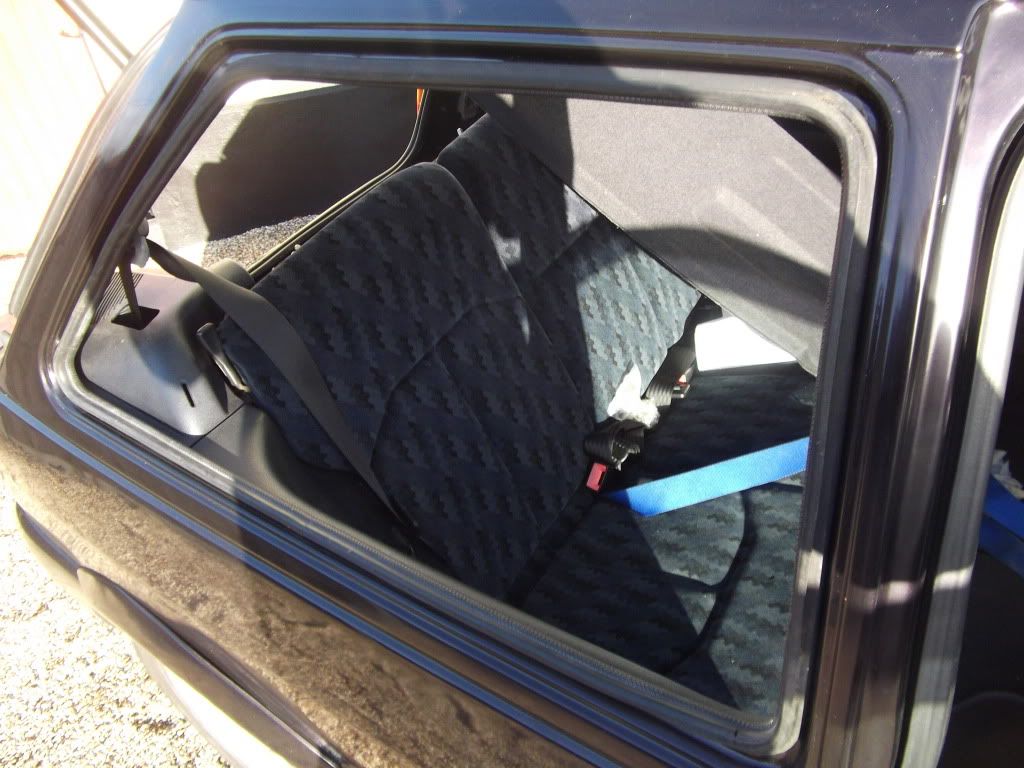

place the window into the quater feeding the rear hinge through the hole in the rear pillar. Then put the two bolts in the two rear pillar holes lineing up the threads in the hinge and tighten.
Next loosten and turn the 2 front window brackets so window fits in easy....
push front of window in and twist the brackets over the rubber by 90degrees so that the holes in the front brackets line up with the holes in the pillar.
look at the window from the outside line it up so looks even all way round, then put the bolts in for the front too brackets....
this is how the back hing should look when folded up and the holes in rear trim correctly cut...
now put the trim back over the boot hydrolis and put the screw back in the top and attach the seat belt (reversal of taking off) and put cover back on...
compleated rear pillar trim.
now put the middle pillar trim back on, and seat belt back on, tighten, and put on cover...
and now.....
the end result...
