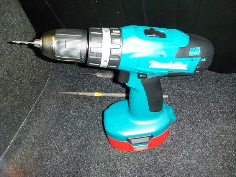

1x Decent drill *Cough* Makita *Cough*.

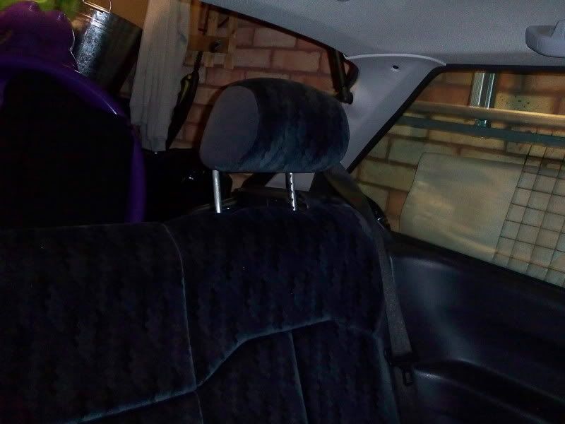

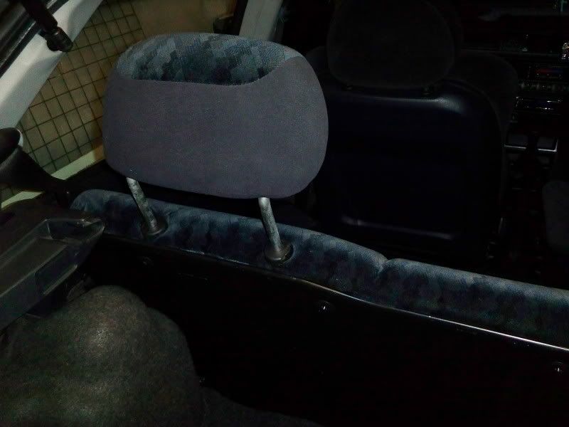

Put your headrest in the place you want and mark out both poles on the back of the seat, do the same for the other side.

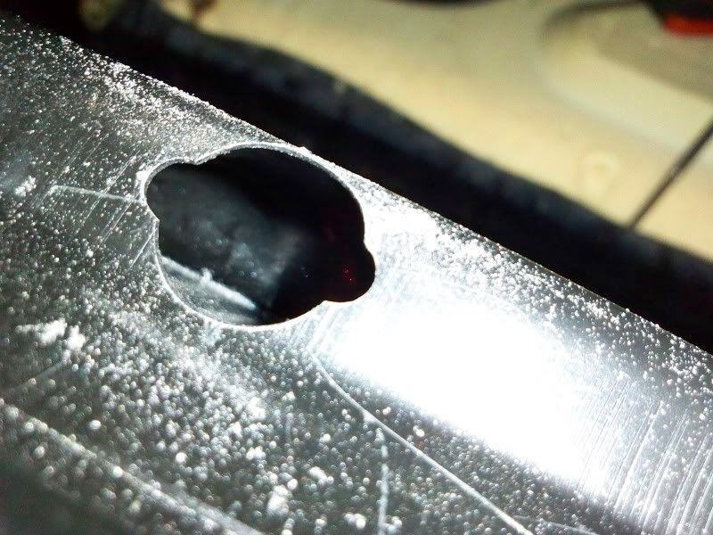

Now that is done you can get down to marking where the holes should go.

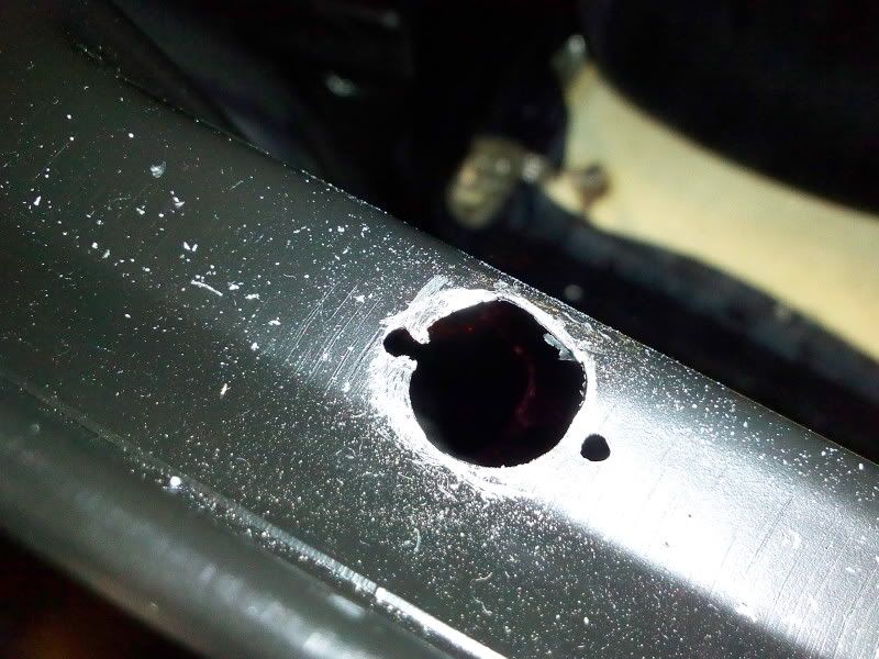

There is a hollow ledge on the top of the seat with a flat bit and a sloped bit on the back. I marked my holes in the centre between the edge and the sloped bit and in the position where the headrest should go. It's probably best to get the headrest and mark up to that as then you know it will fit.
Next drill a pilot hole for the 20mm bit to go in.
Then proceed to drill with the 20mm bit. (I used a flat wood drill bit as the metal bits are extremely expensive and mine only cost 75p from in-excess and it didn't actually blunt it.)

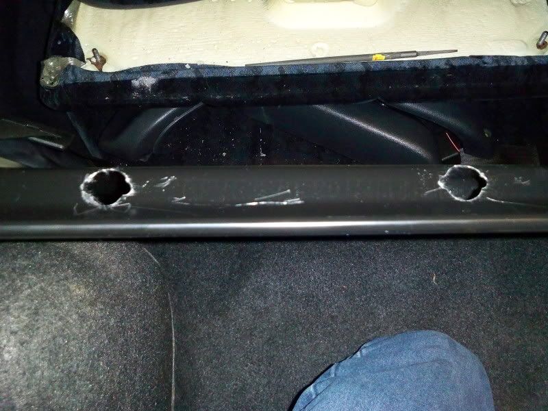

Drill 2 more pilot holes to the left and right of the hole as the anchors are'nt round.
Next you need to file down the big hole with the rounded file to make it smooth and a bit bigger. And then use the completely round file to file through to the pilot holes and make it look like a little face. (Trust me the pilot holes do make it a alot easier!)
Depending on the position of the headrest, another big hole may need to be drilled underneath if the hollow beam isn't that big.

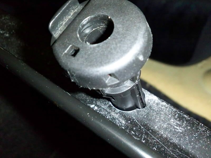

Now try the anchor and see if it fits... if it does.. congratulate yourself with a cup of tea.
