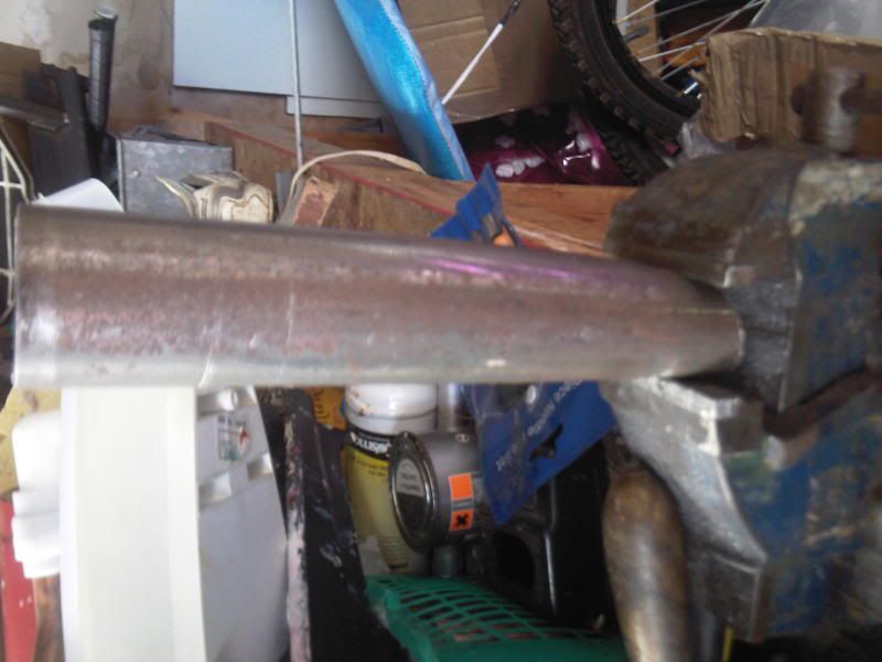

Found 44mm external dia 1.2mm wall steel tube works out right for the throttle bodies and oval
inlet ports when squashed.
The tubes were cut at a angle to match the injector plate
Squashed in a vice to oval as inlet port shape and then cut of the length of pipe, I squashed
them when still on long length of pipe to reduce distortion as if cut off to length and then
squashed the whole bit would end up oval.
