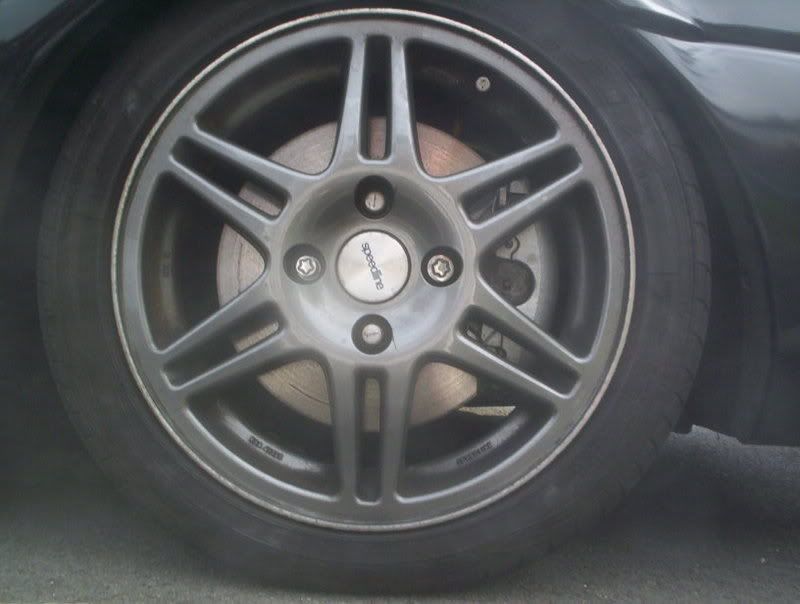

PostPosted: Mon Jul 29, 2013 7:24 pm
I had them on mine, fitted straight on:
