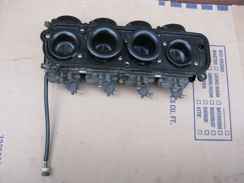

Hi I've picked up a st170 inlet for my bike conversion, the problem I know is my yamaha thundercat carbs don't line up with the ports. Would it be possible to fit different angled silicone pipes. Instead of spacing out the carbs because that would cause the carbs to be unballanced and more work for me. We have carb runners on here don't we. Mines a 2.0 silverstop looking to run st170 inlet with thundercat yamaha carbs. Any idea what size I need to drill the jets out to? I am running piper fast road cams so maybe abit more then standard 2.0's and also the correct needle height for afr. The car has a 421 manifold and scorpion exhaust if that helps.. Need answers guys please help....

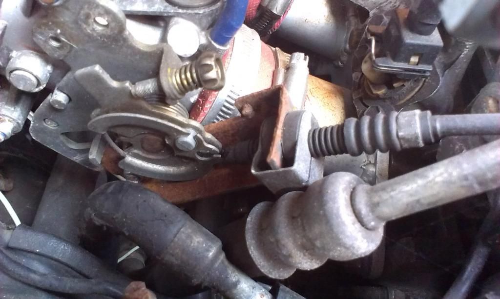

Oh could you also give some information about connecting up the throttle cable for the carbs. Pictures would be great and maybe other peoples carb pictures using 170 inlet or differnt airfilters. Thank

I used the throttle bodies/carb original trumpets, ali back plate and thin panel filter dont think filter socks are ment to be to good for air flow, also made a bracket to use the standard throttle cable, the narrow band lamba sensor/indicator i used has a row or LED's which went from red green amber and showed lean mixture correct and rich and was good enough for basic jet settings however the wide band i now have running fuel injection is lots better but for about 5 time the price

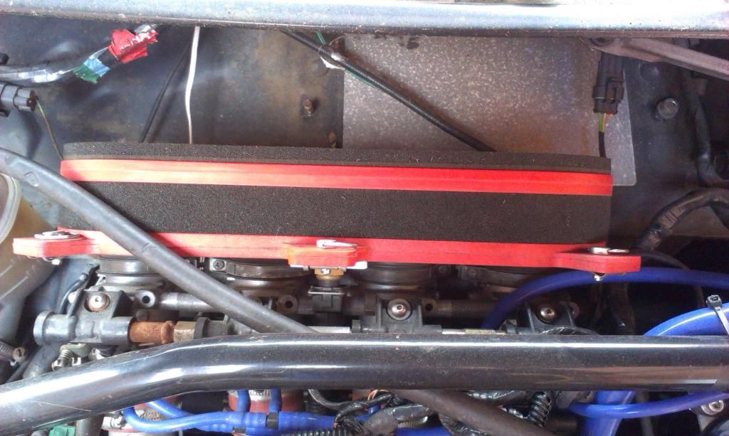

heres my setup
going to be running these on my 1.8 silvertop with microsquirt V3

Looks lush mate, nice setup and looks similar to what is was going to do with GSX-R ITBs :thumbsup:

How are you going to route the throttle cable??
