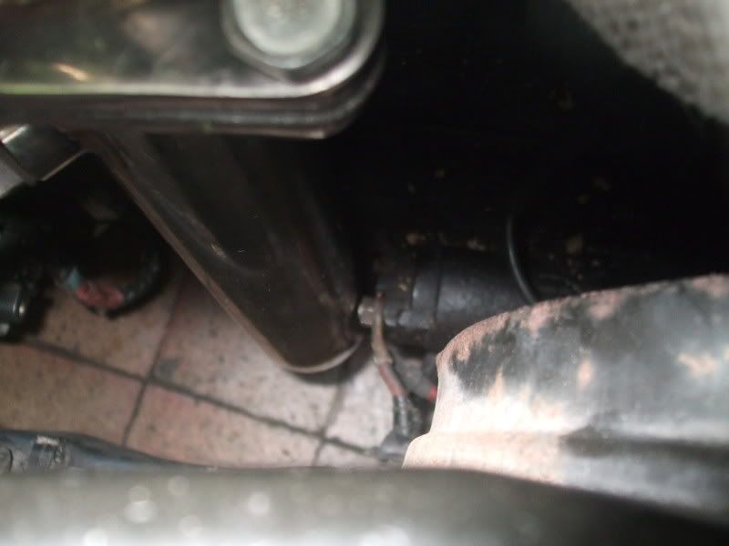

biggest issue is clearing the starter due to it being on the front
you can get a focus st170 manifold as its a 4-2-1 design straight out of the box but will need modding again for the starter
i got a 4-1 for my fiesta and with a little bit of modding with a hammer it just cleared the starter
came from ebay from the states

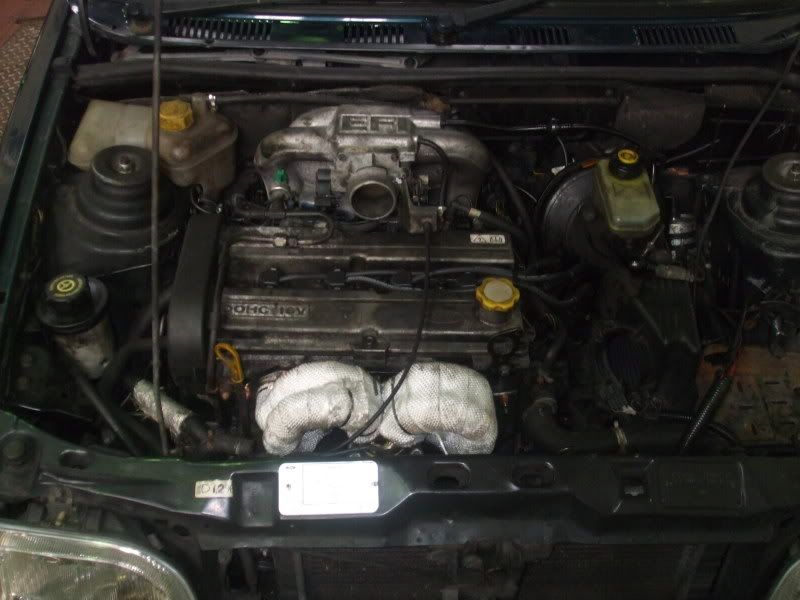

what fiestas that in the pics?
PostPosted: Sat Oct 29, 2011 2:45 pm
Posts: 872
cant remember now tbf i will try and find one
might as well go 2ltr physicaly the same size so no real extra work
that pic was the si with the rs 1800 engine in

is that a obx manifold in pic?
PostPosted: Mon Oct 31, 2011 6:25 pm
Posts: 872
a copy

PostPosted: Mon Oct 31, 2011 10:06 pm
Posts: 872
it will fit the 2ltr aswell
a little bit the smaller starter motor either get a down pipe made up or get the hammer on it to give a little clearnace for the starter and heat wrap the starter. and get a pipe made up to connect to the rest of the exhaust
