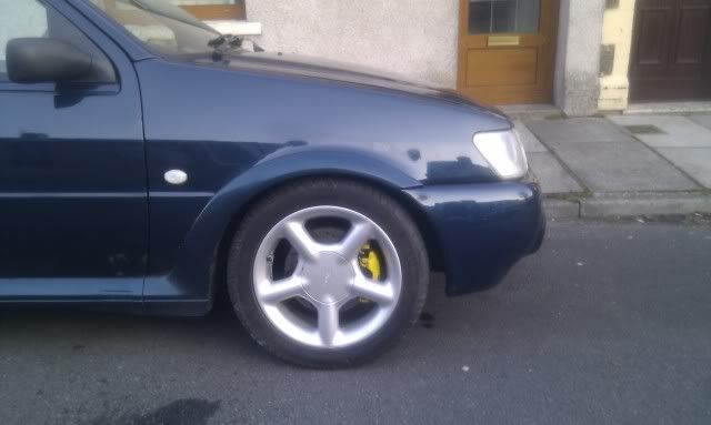

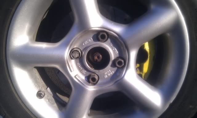

heres 260's behind 15" wheels, about hand an inch gap
and 260's behind 14" 16v wheels

I'm currently using mk1 V6 mondeo calipers with 278mm discs, I'm using the mk1 mondeo calipers as the pads are wider than the mk2 v6 mondeo pads, with this setup you have to use 3mm disc spacers (spacers between the hub and the disc, not the disc and the wheel, you can buy these from puma speed) and these are more than capable of stopping a mk3 fiesta with no other brake upgrades, they also have a 60mm diameter single piston which I believe is the same as cossie calipers
