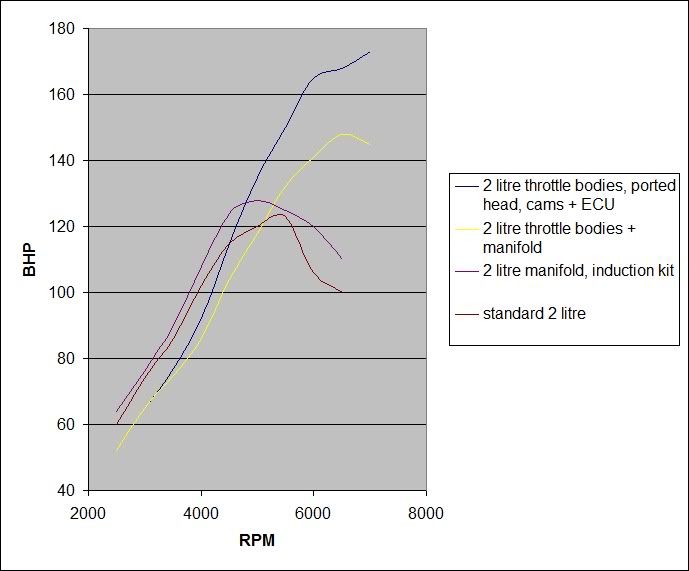

Over the last couple of years ive modified the Si and had it on the RR each time so see what improvements they made, rather than look at a number different sheets ive had a play with excel and put them all on one graph to show any one interested in the various improvements.
to add some more info
standard 2 litre silvertop
2 litre, Ashley 4 branch manifold, decat pipe, cone filter & ali cross over pipe.
2 litre, Ashley 4 branch manifold, decat pipe, individual GSXR600 throttle bodies, cone filter,
2 litre, Ashley 4 branch manifold, decat pipe, individual GSXR750 throttle bodies, 270 cams, DIY ported head Emerald ECU.

pretty impressive will :D
nice to see how each stage of the mods have affected things :chill:
PostPosted: Fri Nov 05, 2010 9:21 pm
thats really good puting it all together like that, very impressive power too. Has it been expensive to get it to the current stage? It would be good to see something like this on the main site for modifications.

ty for sticking that up Will, very useful
