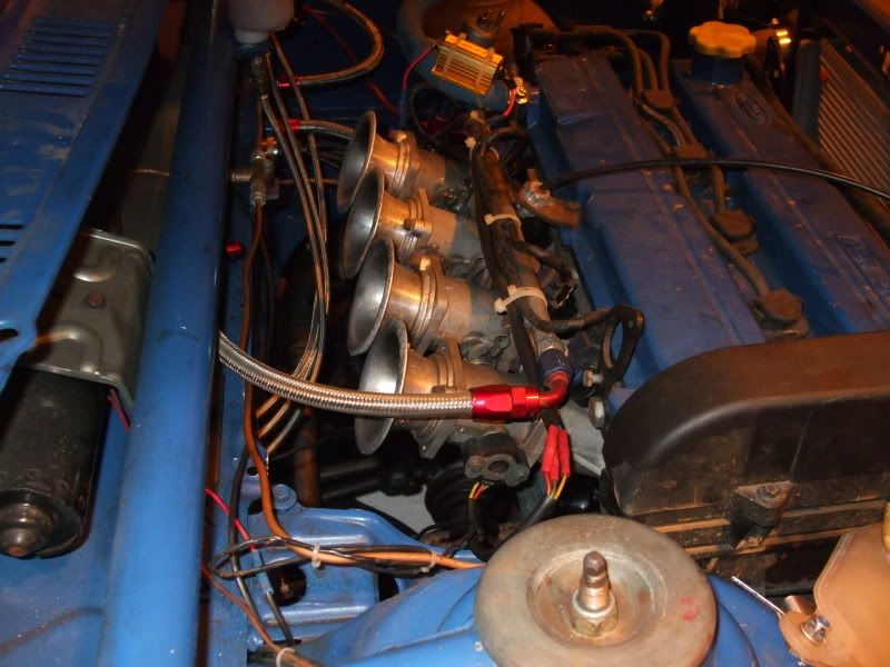

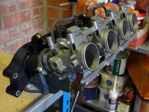

not a lot of room especially if you want to run a filter, i dont know what the angle of the ST inlet is but most clearance is gained by being angled up to miss the bulkhead, GSXR throttle bodies bit longer than purpose made car ones but have got both GSXR600 and larger 750's to fit ok with short trumpets
750 set up on the bench
600's
current 750's with filter
Will

this is what GSXR throttle bodies on a ST manifold setup looks like dont know what angle is though as from another web site
Will
