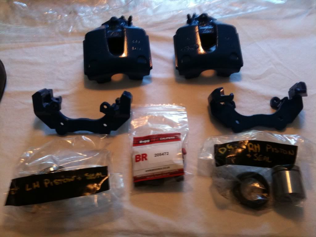

Here's my current affairs with regard to my new st150 brakes, had a serious issue with the powder coaters taking forever and not really doing a good job so here are a few pics of where i am at as of this moment.
what i have at the moment

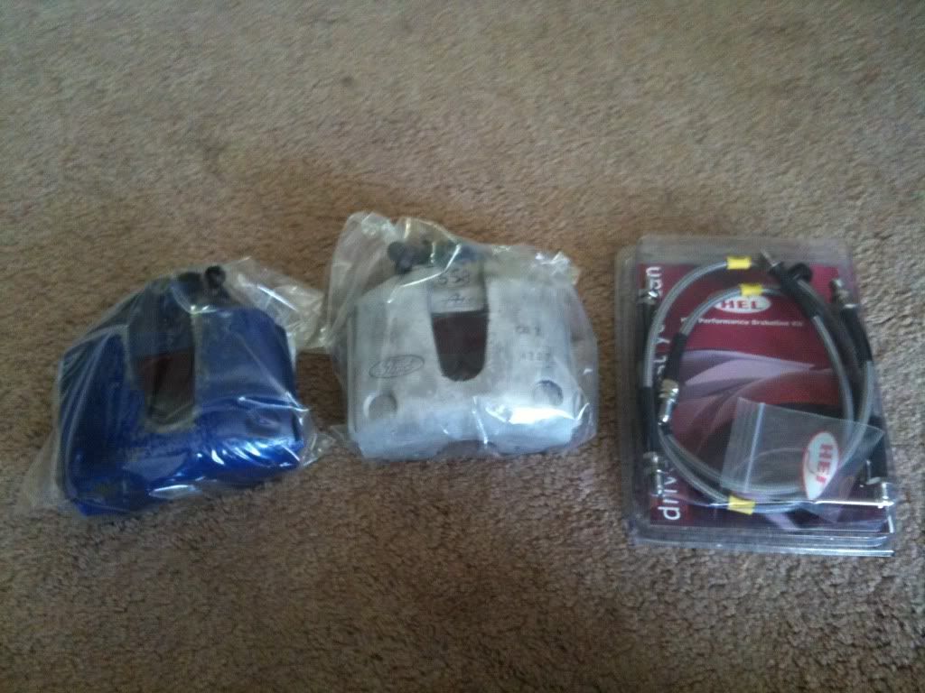

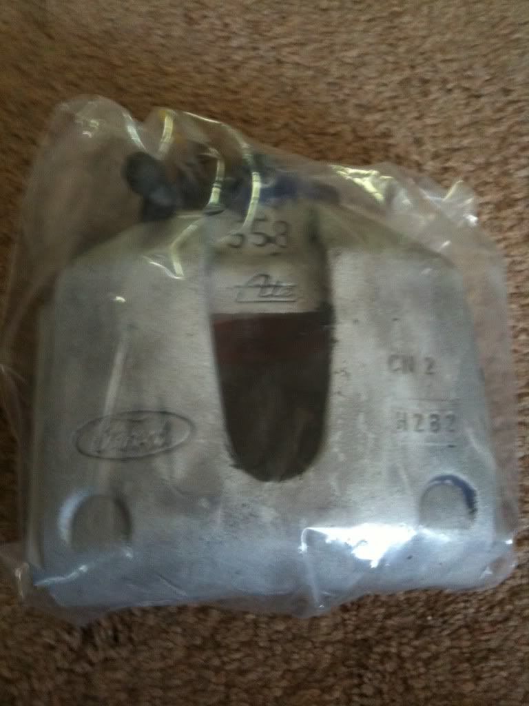

then heres the 1 caliper fist already blasted

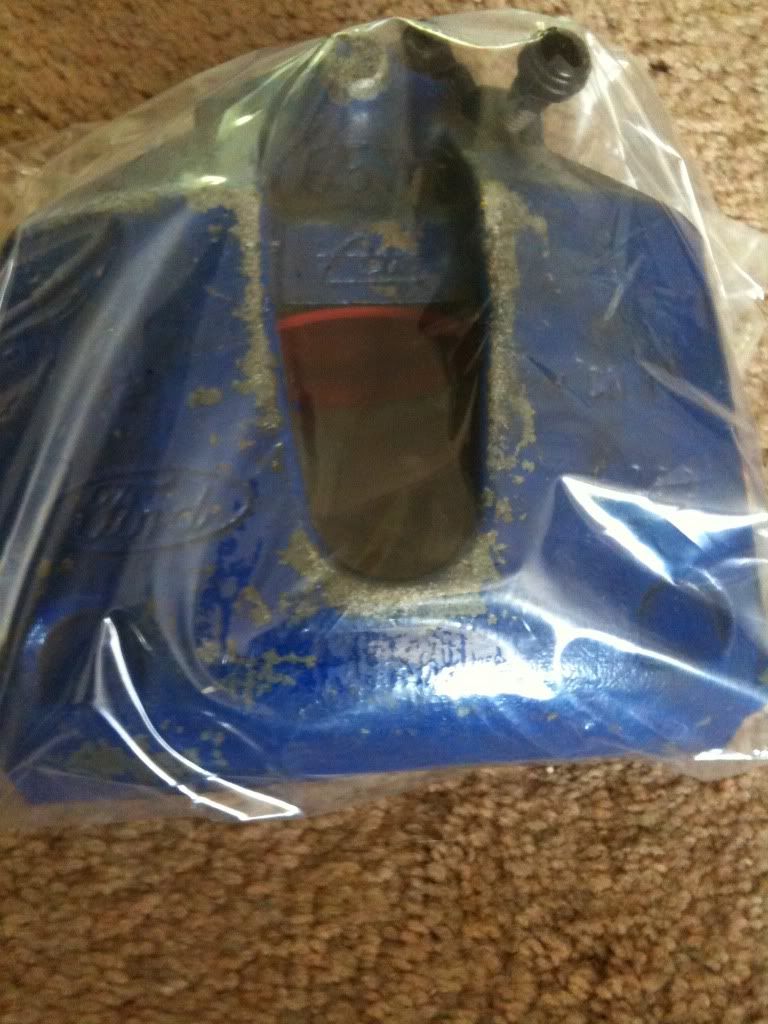

This one hasnt been blasted yet, as you can see theres a little damage to the paint which is why i wanted them re-done

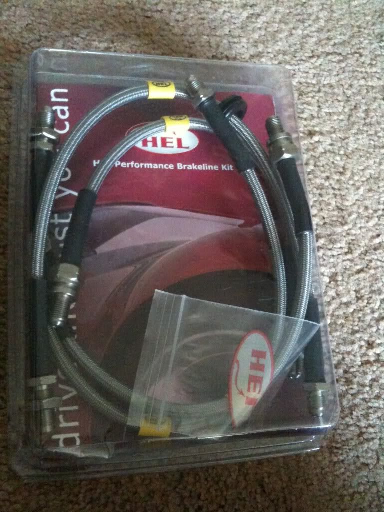

These are my nice new Braided brake lines, fresh from HEL

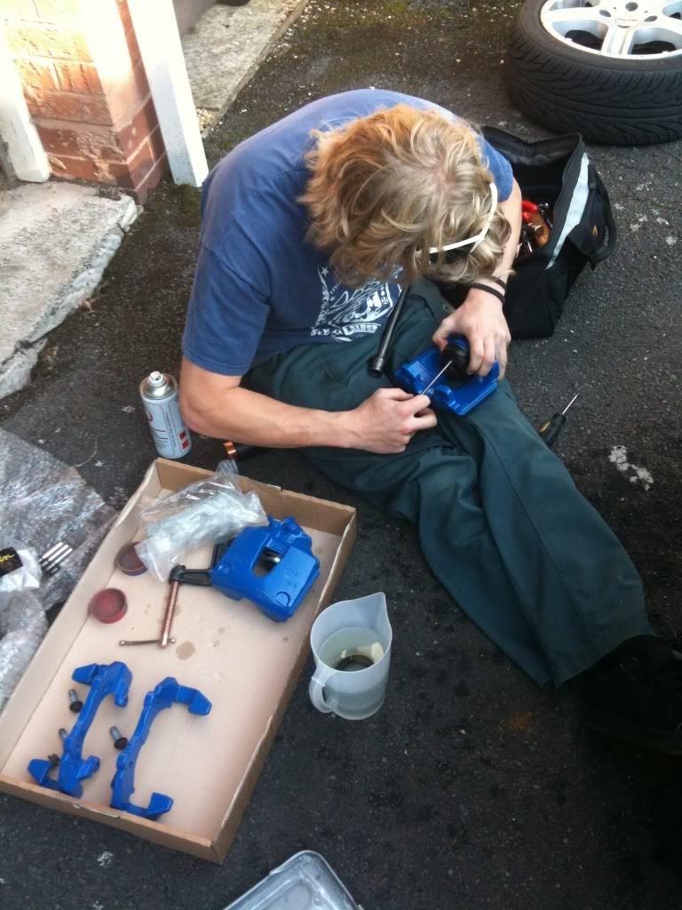

and heres my mate being super professional while taking the piston out, all wrapped up for the powder coaters
will put pictures up when i get them back from the powdercoaters later this week :) :thumbsup: :)

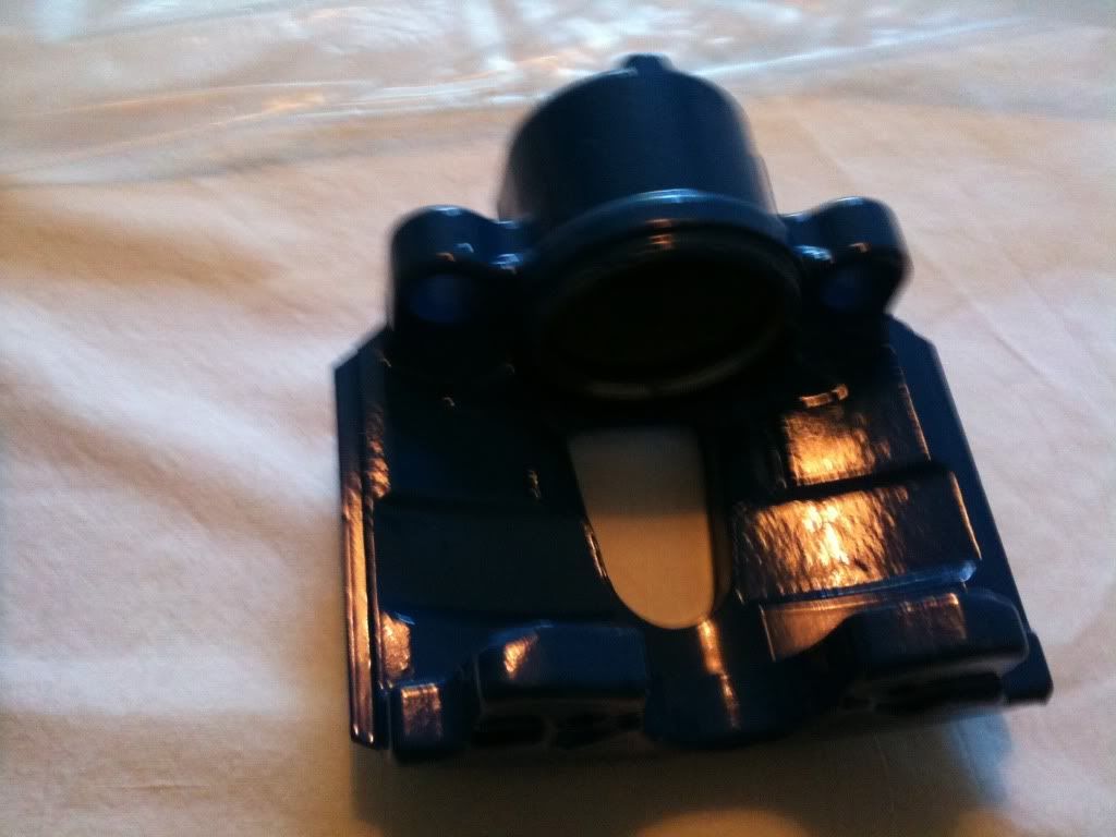

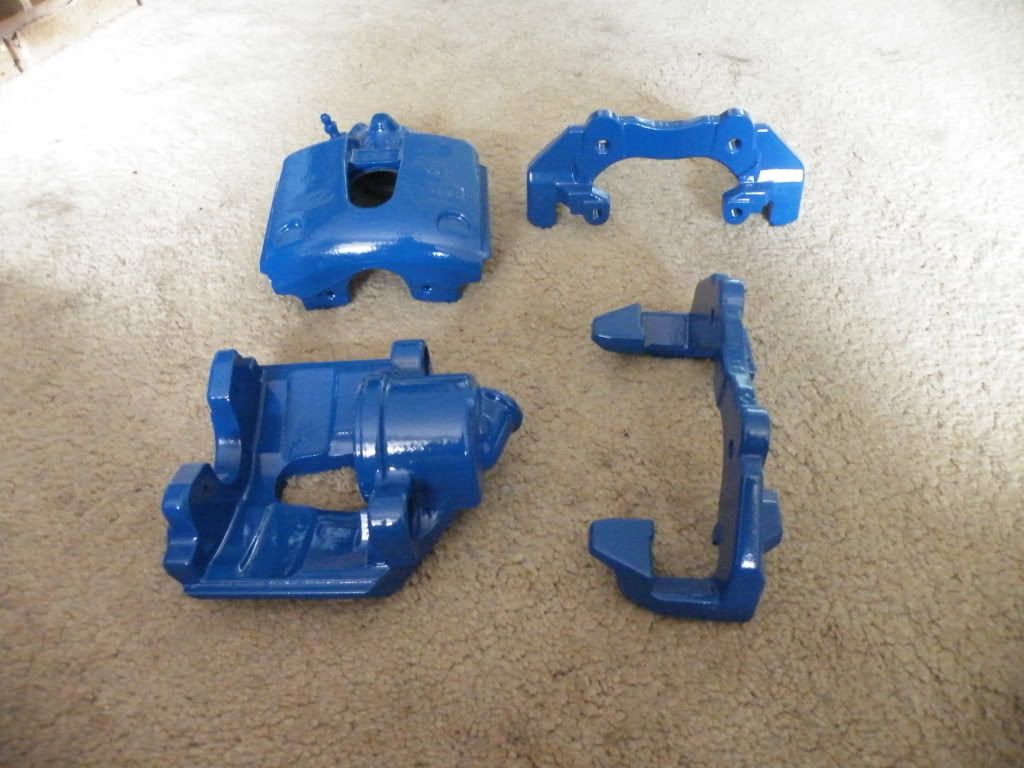

Here's an update of where I'm at with the brakes, they are now back from the powder coaters and looking good and shiny. Ive also got a new seal kit, safety first lol
I've got some better pics but I've done these on my phone

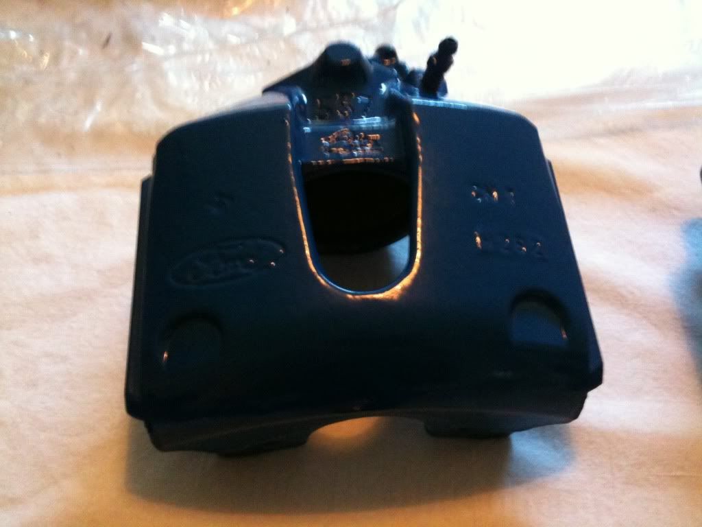

here are the better pics of the powder coated brakes.
this 1 really shows the colour well.

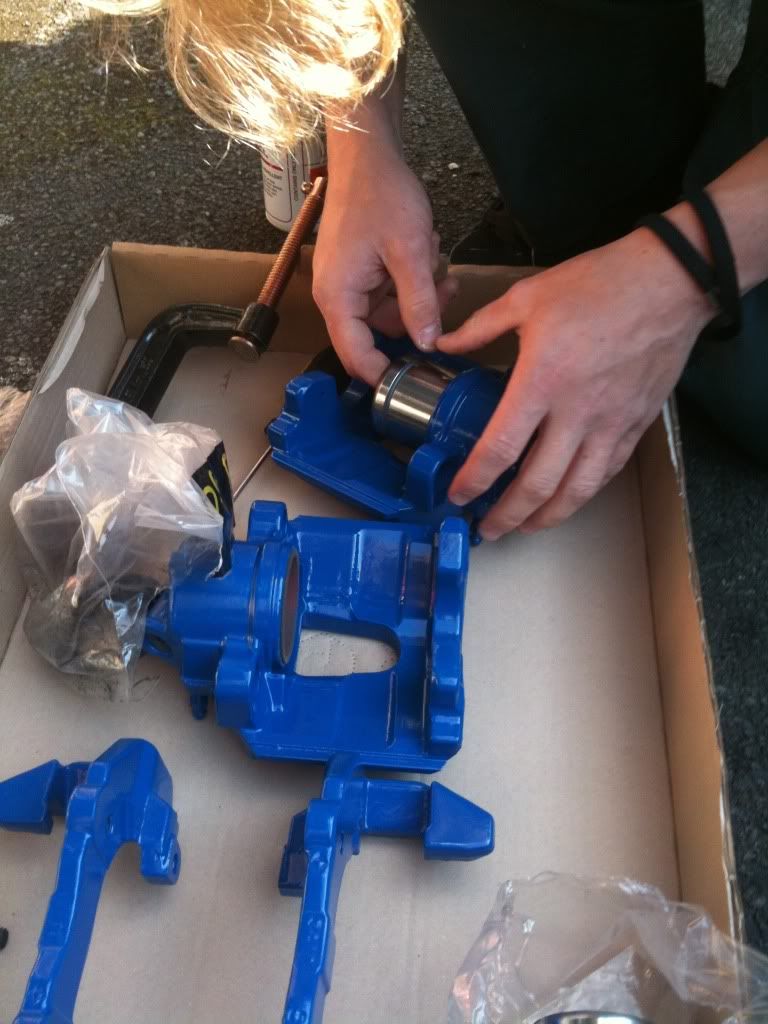

Just had another major hiccup with the brake conversion, I had it all set up ready to go, got the pistons in but for the life of me I couldn't get the new seal on. After almost an hour and a half of prying the thing on to no avail I gave up and my friend has taken them to his work to have a go there. Hopefully have them on early next week. Arghhhh it's taking so long.
PostPosted: Fri Aug 27, 2010 9:22 pm
Posts: 616
Location: West Midlands

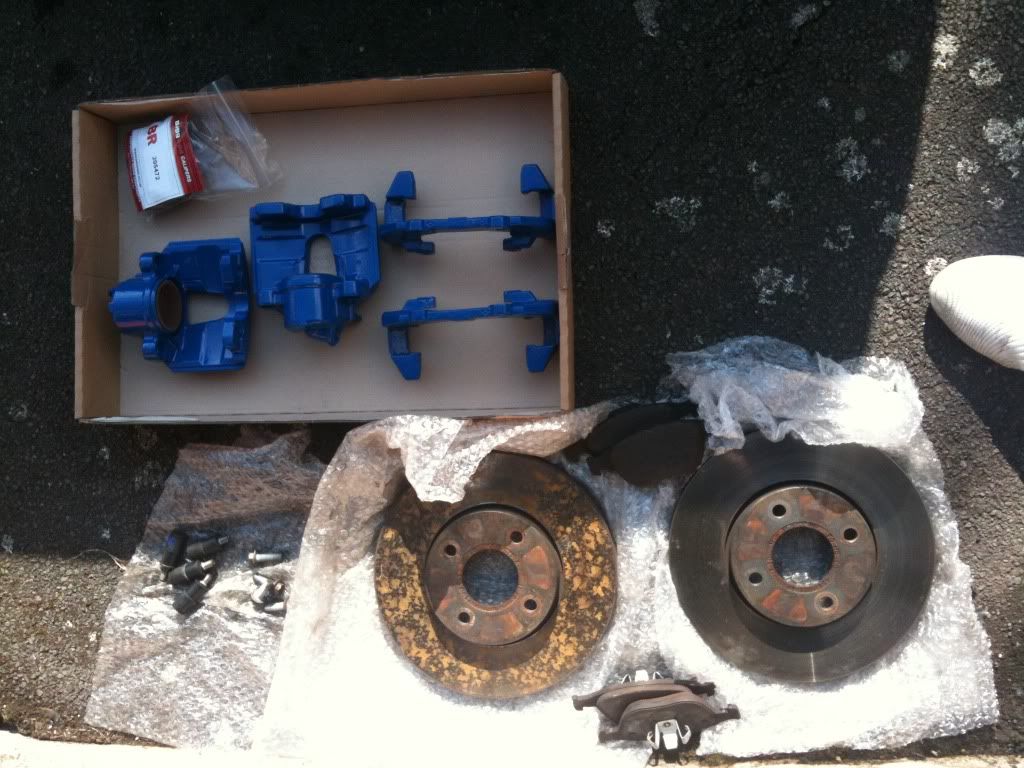

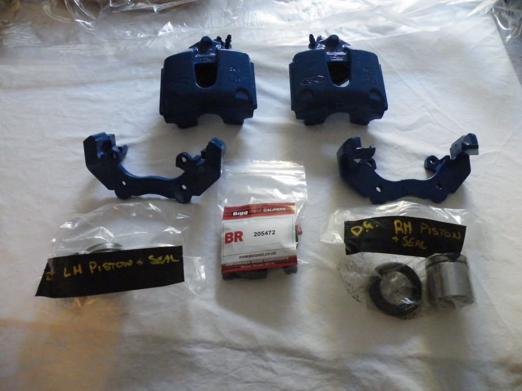

So here we are this afternoon all ready to go, everything in order ready to fit. Discs-check, fists-check, carriers-check, pads-check, seals-check... etc...etc

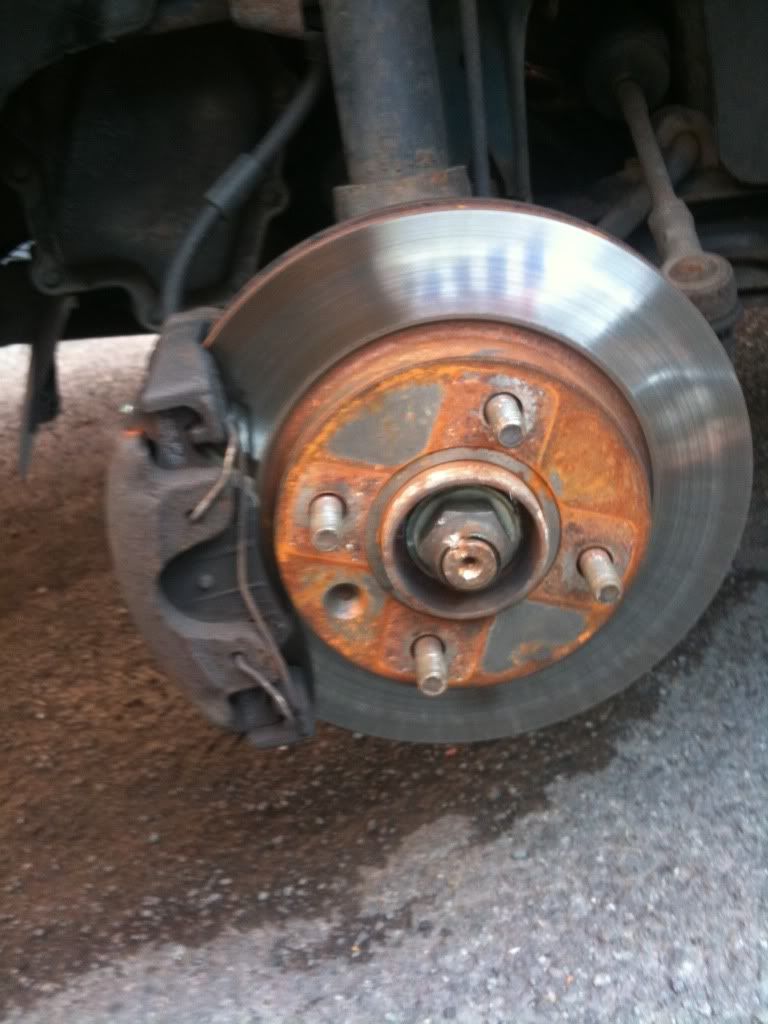

Nice shot of current set up

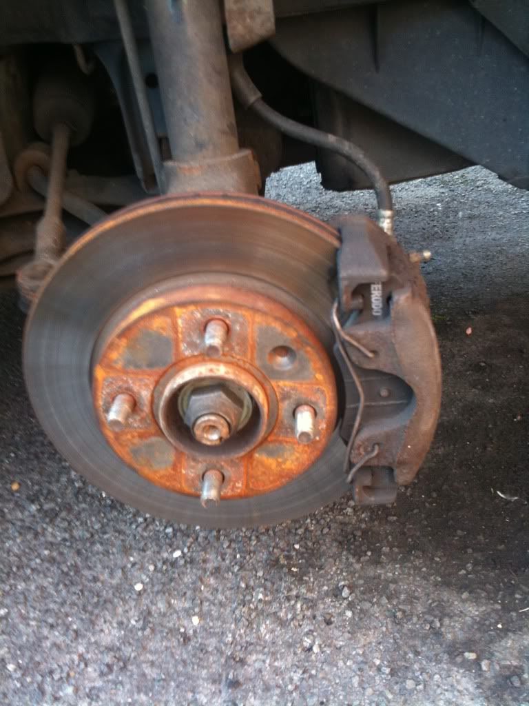

old set up ready to come of (this was taken for a before after shot)
same again on the other side

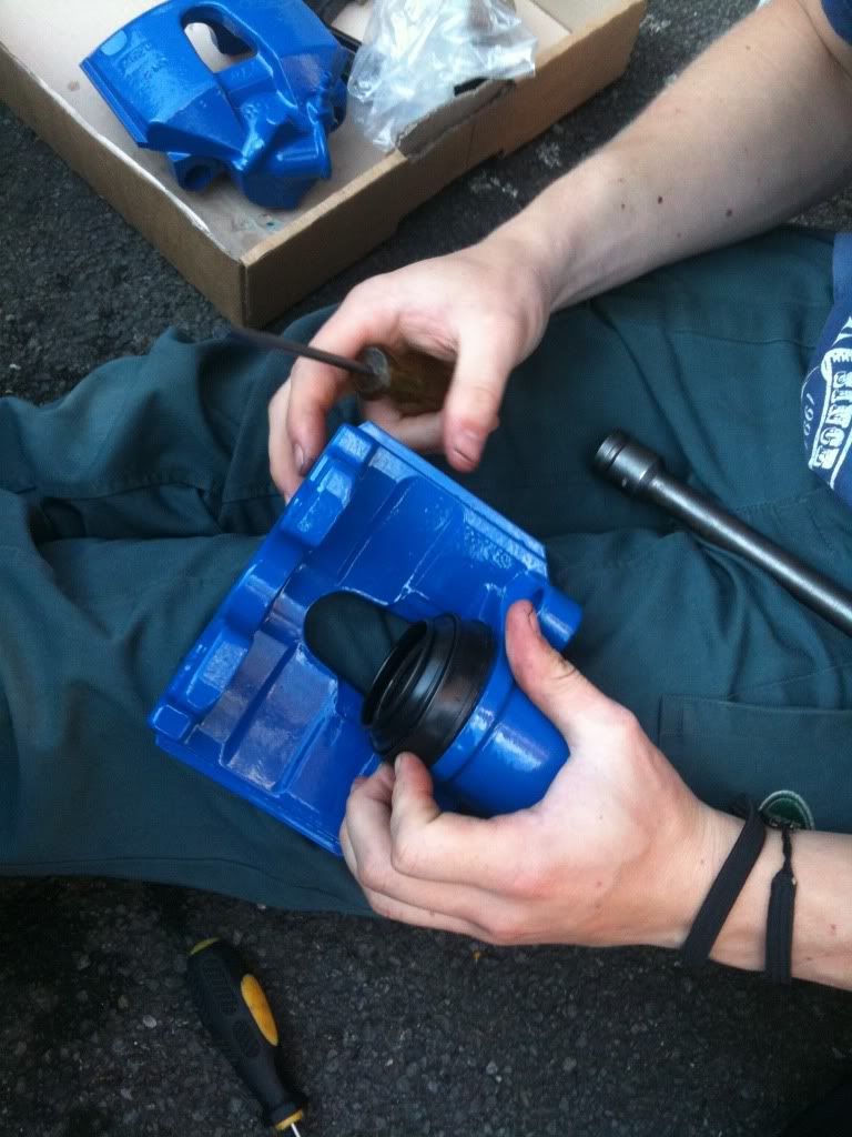

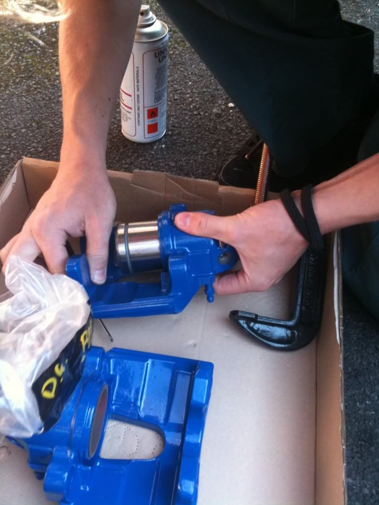

Pistons going in
Duhduhduh... our problems begin. stupid seal wouldnt go on, we reckon the powdert coaters F***ed up by not taping up the lip where the metal ring of the seal fits on to the caliper. the tolerance fit is therefore too much and we couldnt get them on.
so they're going to Gaydon to get some Jag Land-Rover excelence. hopefully he will either get the ring ons with the use of some other tools at work or use something to file the paint back off where the p coaters oversprayed. needless to say im annoyed at the quality of the p coaters work.

good work on the callipers, regarding the piston dust covers,
make sure you have clean hands and that the inside of the caliper is clean and free from dirt, shot blast and powder coat, and remove the bleed nipples and brake pipes
first of all use a light grease like petroleum jelly (vasaline) on the seals and a light smear around the piston
put the dust cover on the piston first but near the bottom not in the reccess, but also so the bottom of the dust cover is hanging off the piston,
then fit the dust cover to the caliper (while the dust cover is around the piston still)
then gentle push the piston down making sure it stays level all the way down
