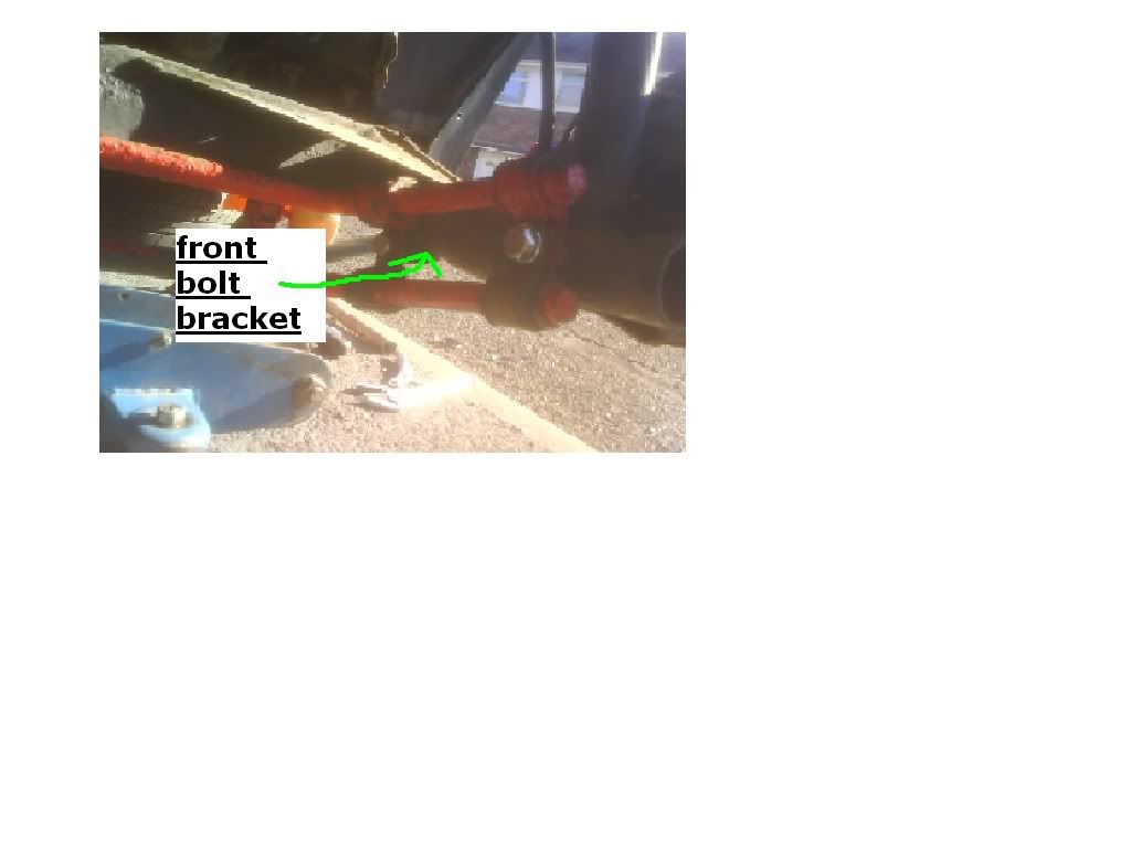

the rear bar just fits onto the back axle with 4 bolts but im not sure if the 1.3 rear axle would have the brackets for the front bolts, ill try and find you a picture of where the bracket is located so u know what to look for :thumbsup:

found this pic. hope it helps

rob your fiesta wont have the bits required for a rear anti roll bar my 1.3 was the same i just put a si rear axle on it, it made a big difference and has harly any roll on the back :) as with the front you need the wishbones carriers from a si with the bolt holes for the anti roll bar bush mounts and shocks with the mount for the anti roll bar link joints also with the si wishbones carriers they have and under car brace nuts to bolt on and make the car stiffer doing this to my car in the next few weeks :) and having a front anti roll bar will make a big difference comparing my si to my runabout :) well worth doing imo
