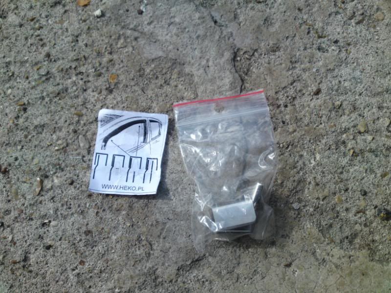

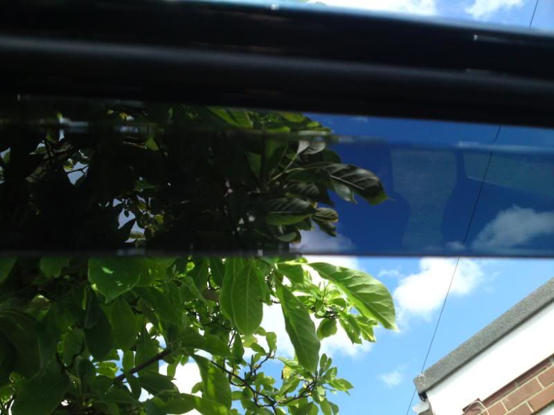

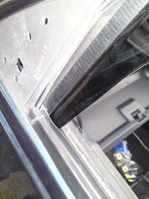

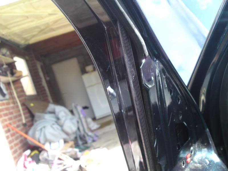

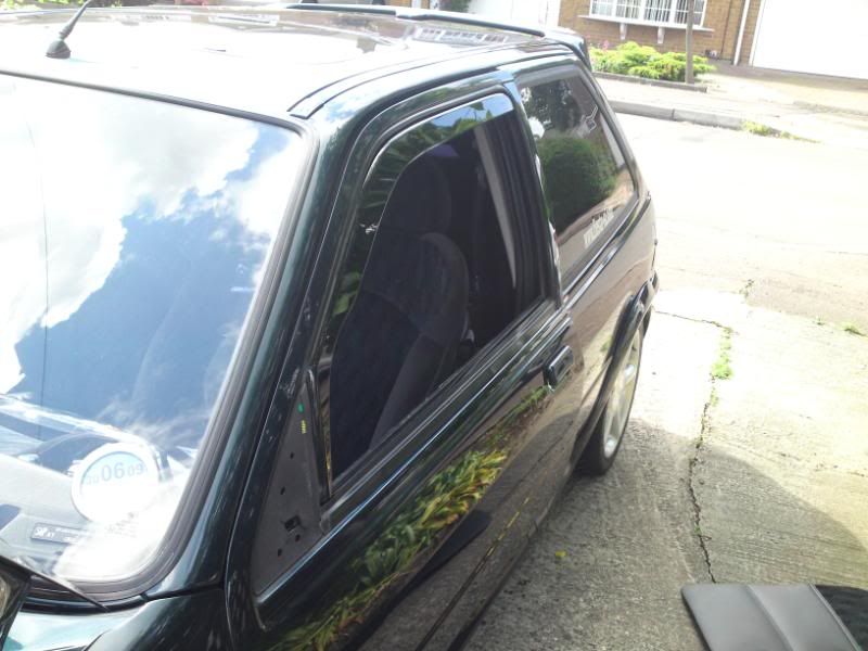

hi ive got some window deflectors for my 3 door si and im having trouble with it ( im being a donut basically :lol: )
ive taken the passenger leccy mirrors off for extra room
got the deflector in the door frame just cant work out where to put the metal v shape clips to hold it in secure and not sure if ive put it in the right place due to some of the rubber seals on the car
heres a few pics if someone can help me cheers :)

the little v cutout goes on the wind deflector side, cause it grips onto it.
The window does up into the v clip to stop the window hitting the deflector.
if this makes sence the order from one side of the gap to the other is....
Wind Deflector - V Clip - Window - V Clip
Hope this helps :thumbsup:

are you meant to took it behing the weather strip? mine just sits on top.
