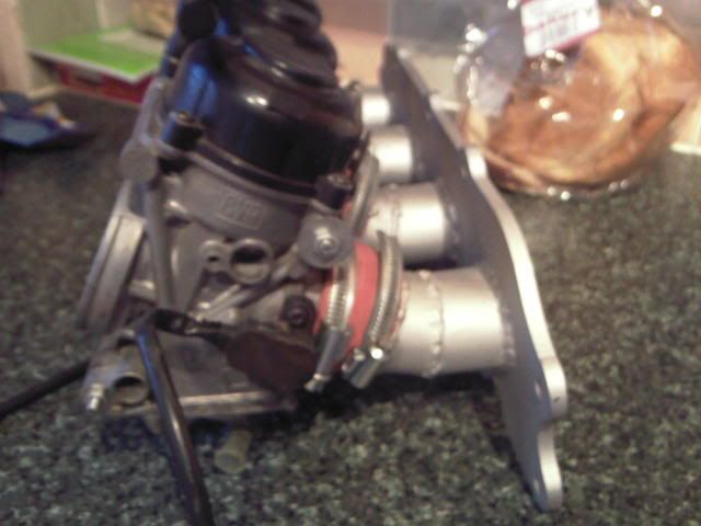

been doing some more looking around and am gonna go for the carbs,
so to recap all i need is
:manifold plate (i can weld) so can make the bodys fit right
:ESC unit
:600cc Carbs (what needs to be done to them? or do they work out the box so to speak?
:fuel pump to match the carbs ie from the same bike, (how would i fit this?)
