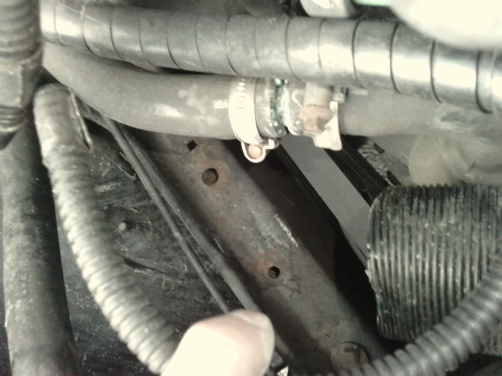

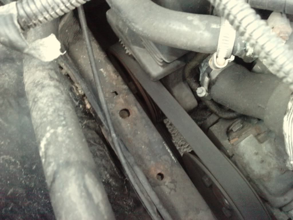

i got a zetec alternator, s/s cat back exhaust now and 2.0 cams
these are the holes i got in my chassis leg:
are they 4 the front zetec engine mount?
PostPosted: Mon Jan 18, 2010 10:25 pm
Posts: 304
Location: Nottinghamshire
Heres some pics mate to show what needs doing
Rear mount
before
http://www.fiestaguides.co.uk/images/en ... ig/202.jpg
after
http://www.fiestaguides.co.uk/images/en ... ig/203.jpg
Front mount
before
http://www.fiestaguides.co.uk/images/en ... ig/305.jpg
after
http://www.fiestaguides.co.uk/images/en ... ig/307.jpg
