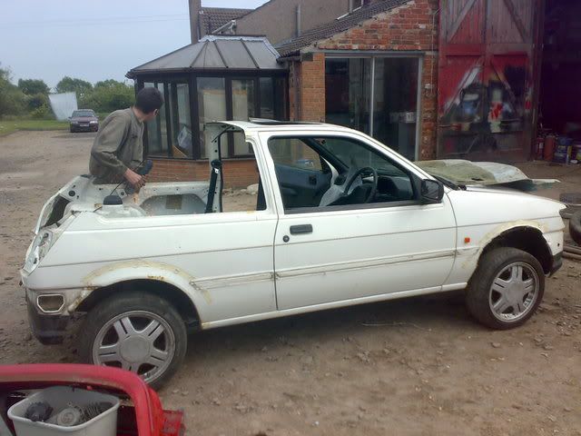

thanks guys sounds like alot of grief but they do look great where the mondeo ones just look gay dont suppose you have any pics of such butchery so i can get a better idea of whats involved :thumbsup:
 Post subject: Re: escos wheels
PostPosted: Mon Jan 26, 2009 2:28 pm

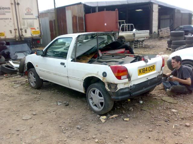

see the front arch on this.... this is how much mine is trimmed by.. only 10mm of wing left to stick the arch kit to..
also same with the rear end, look at the first picture and see how much we cut off!
also trimmage of bumpers and kit needed.

Christ Paul.... I realised it would have been a brutal build but that's verging on fire brigade training style modd'ing :shock: :shock:
Looks much better now though ;)
