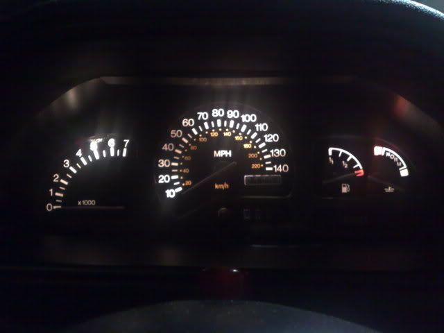

yeah i did with mine, i compleatly got rid of the front light illumination and made them back lit with white lights ;) took alot of time to get it right but basicly i just fitted 4 white bulbs in behind the clock, 1 on the rev counter, 2 on the speedo and 1 on the fuel and temp and then wired them into the light behind the heater control 8-) works really well and i also removed all the green filters from the swiches and clock in the centre consol so they all light up with white light :)
PostPosted: Sun Sep 28, 2008 8:34 pm
Image[/quote]2
that looks superb m8
PostPosted: Sun Sep 28, 2008 8:52 pm
its not that hard to do, just take the cluster apart so you can get behind the dials, and use sidelight bulbs behind them ;) and then just sire them all into a junction box then wire a lead into somewhere which gets power when you swich the lights on, not the clock tho as its always on and confuses you at night because as soon as you swich the car on the speedo light up and you think the lights are on :lol: did that the first time :doh:
