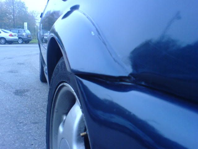

nice 'mallard' green example there dude :insanity:
that first picture highlights the exact reason i dont want them on mine
JJ

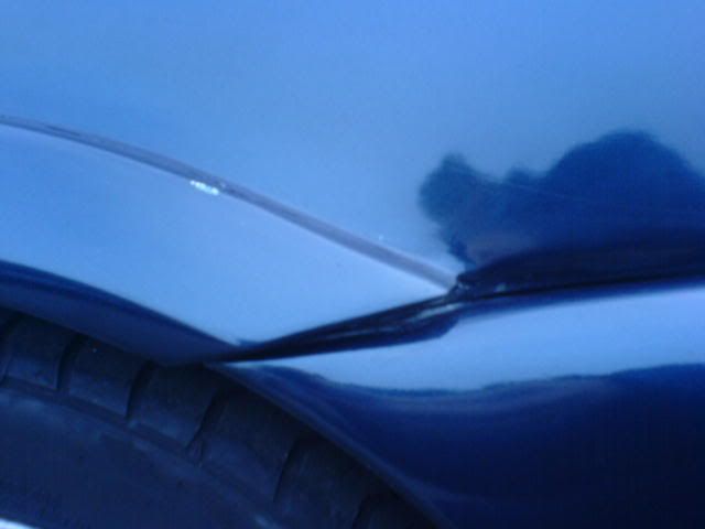

they do look good. all apart from where it meets the Si bumpers. you know how pathetic i can be with little details

i know its not close up..i never really took any close up pics of it..i know the front bumper sits in a bit....i still need to take the screws out and bond a rubber block on the back of the bumper so it sits level with the arches.....
this pic is from when i got it back from paint....about 5 mins after i got it back actually!!...so the pic is a few months old!
