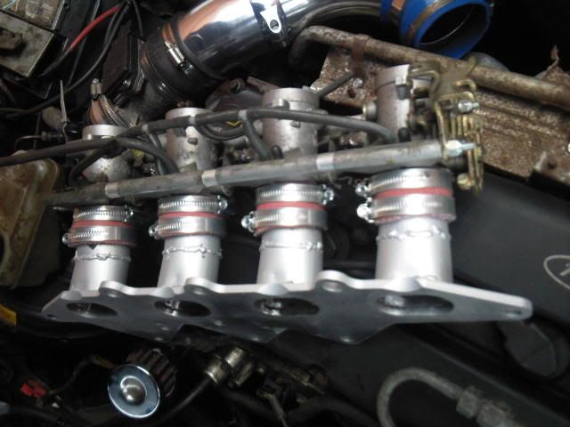

With a properjenvey throttle body setup on a 2.0ltr with cams and obviously aftermarket management your looking at up to around 180bhp
With bike bodies you will have a lot less spending, but aim around 170ish or so depending :thumbsup:

my standard 2litre on motorbike throttle bodies using standard ford ECU proven 150bhp @ £175
i think this is the limit of using the standard ECU, however estimate;
same motorbike throttle bodies set up with aftermarket ECU 160bhp megasquirt £400 omex/emerald ECU £800 but think the megasquirt route cheaper but needs knowledge to programme.
ported head, rod bolts and cams 185bhp extra £800 + ECU reprogramme plus above costs.
at this state still should be reliable, but not the ultimate power of a turbo. using Jenvey or AT throttle bodies not a great advantage over motorbike converted ones as do the same job just easier as a basic bolt on job and plug and play preprogrammed ECU but as said above £1500.
