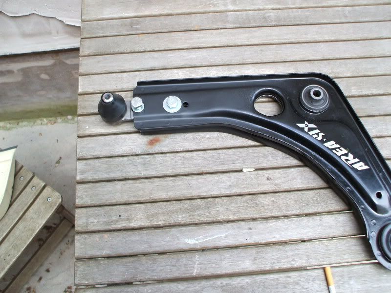

These pics show Ian Howells.. doesnt look too hard.. although the wishbones we normally get have 3 bolts, but same principle reallly..
Slit 15mm into the wishbone at one point, slit 15mm into the ball joint bit.. then it has points on both bits where the bolt wont move if you get me.. but as the ones I get have 3 rivets/bolts in I shall be doing the exact same thing but have 2 bolts at the inside edge

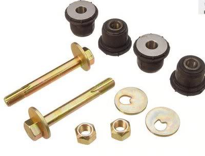

have you thought of possible adding 2 welds and a cam so to speak on the bolt? its what all the rangies use as standard as everything is fully adjustable because of the air suspension, would imagine that it would be a lot stringer/better as it would mean that no matter how much force is on it the botl 100% wont move.
will try and find a pic so you know what im on about.

right cant find a pic of the welds but did find the bolts, can take a pic of welds 2mora for you though as im replacing 2 lower arms on a sport at the moment which is why it came to mind when i read your post.
here are the bolts though if you can see what i mean:

Well they are finally modded.
Got no pictures or anything, but basically we managed to squeeze around 8mm of space to push the balljoint back.. this therefore has brought my camber in a fair bit being on 60mm on the front.
