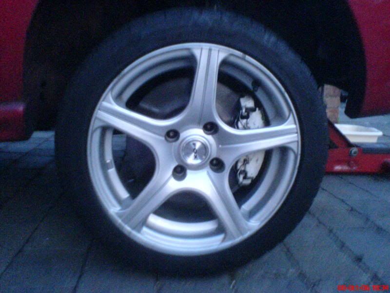

Here is another pic of the ST150 setup behind 15's

I'm running 15" steelies.. 4x4 cossie calipers fit with bags of room.. I have sorted out a set of ST150 brakes which I should be getting on Wednesday, so i'll soon find out!
