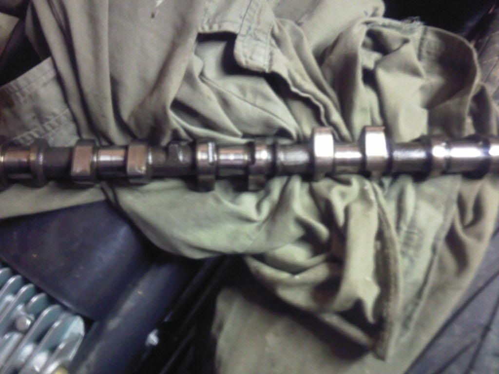

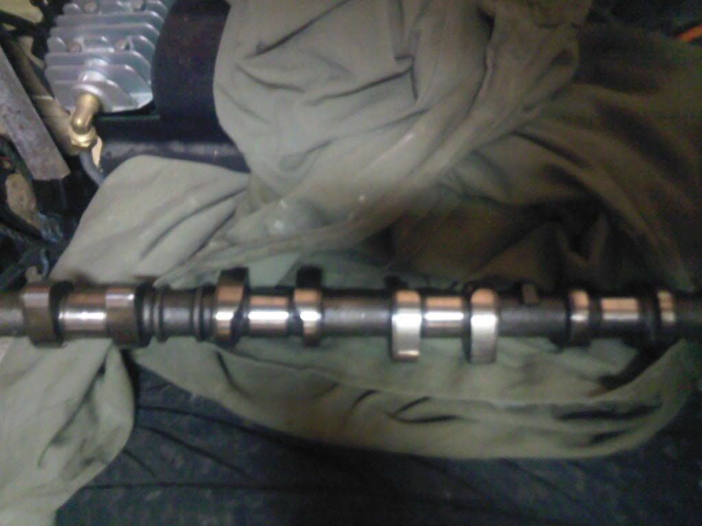

they apear to be the same in lift profile 9.7mm inlet and 8.6mm exhaust but would look like they have different identification casting rings on them, there is some info on web site below and just to check been out in the garage to look at mine and it seems like might be correct and i have a RS1800 and a 2litre 136 pair
RS1800 inlet
2litre 136 inlet
Will
