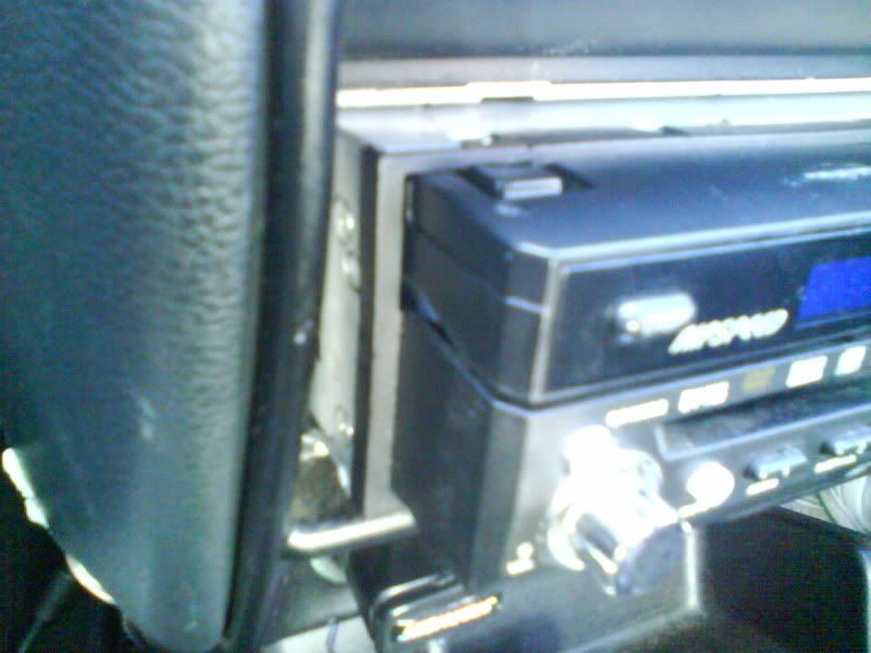

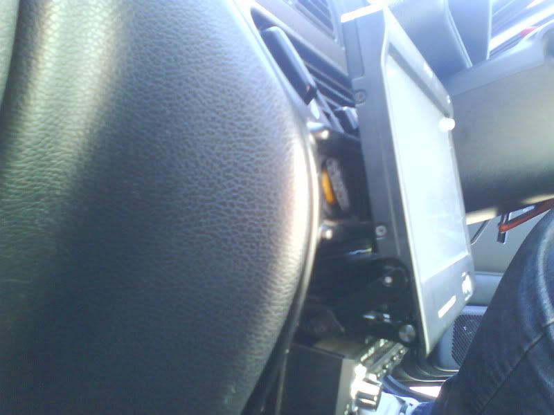

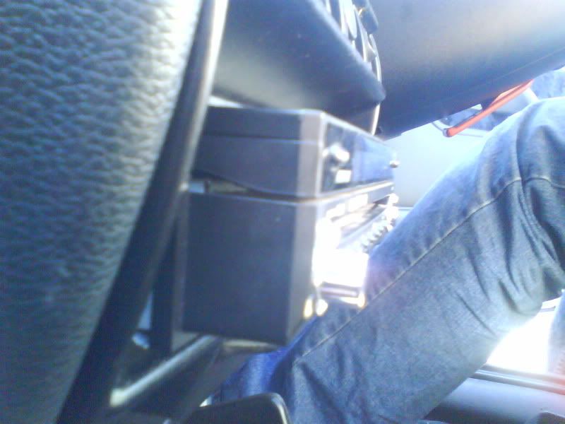

Onto the real subject, i just replaced my sony headunit with a ripspeed one i got on the cheap from a friend of mine, now, the only thing is, in order to have the screen at a viewable angle, the unit itself has to sit out slightly from the cage (pics will explain all).. So, i was wondering if anyone has one, or something similar and has done something so it doesnt look so sticky-outy.
The unit itself seems fairly secure, but you can easily see its not in its cage, and it could cause some chavs to attempt to break in and steal it (although, i used to leave my other headunit in my car all the time for near 2 years now and its never happened) but i dont want it to happen. So yea, any help would be good.
Idealy too, i would like to keep it in the same place, and not put it down the bottom of the centre console as using the touchscreen would be a bitch lol.

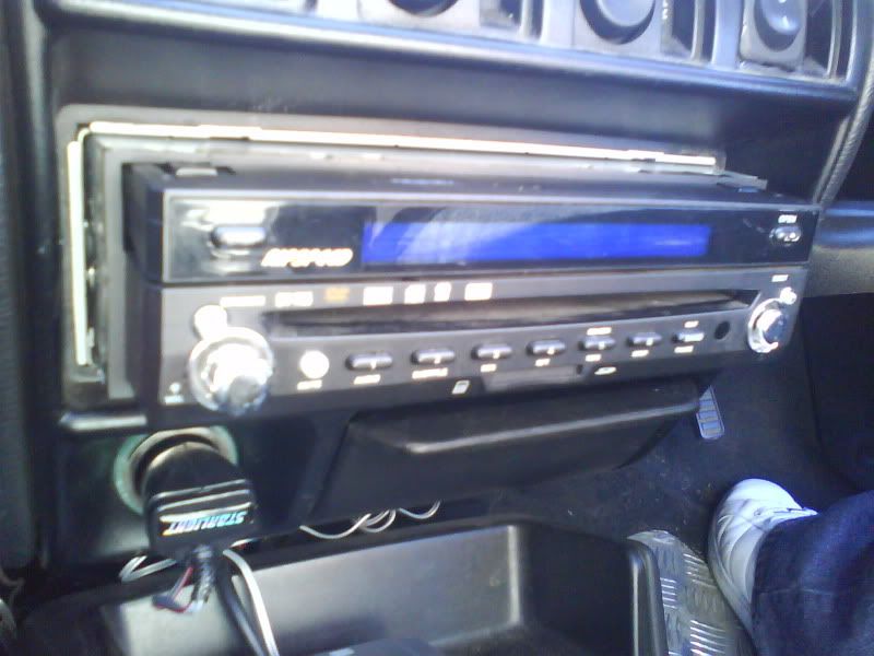

This is how it currently sits...
And being like that, it allows the screen to come out nicely like so...

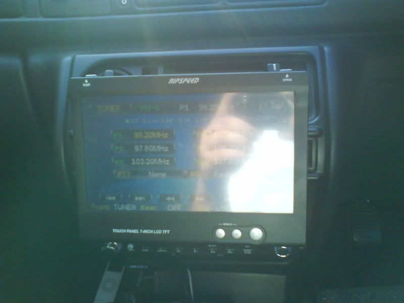

But, if i was to mount it in the cage properly, it would mean the screen would be like this... which is just gay!

iv got a pioneer one you can secure the cage where ever you want,
i just put mine slightly out secured the cage in place so the head unit locks in and set the screen to where you want (not sure if yours has this option)
also my cover sorround for the head unit/cage covers quite alot but iv still got a slight gap if your looking for it
PostPosted: Sun Aug 09, 2009 7:47 pm
Ahh i think i see what you mean, just pull the cage out a bit then push the little tabs out so it locks it in place.. Seems a sensible way of doing it! I might spray it black or something so it blends in with the dash a bit more :) Yea mine has a tilt option for the screen. Ill give it a go later. Thanks :)
PostPosted: Sun Aug 09, 2009 8:17 pm
you got it :thumbsup: i did spray it too :lol:
PostPosted: Mon Aug 10, 2009 3:30 pm
thats what i was gona say to do aswel lol, just make sure it properly secured.
