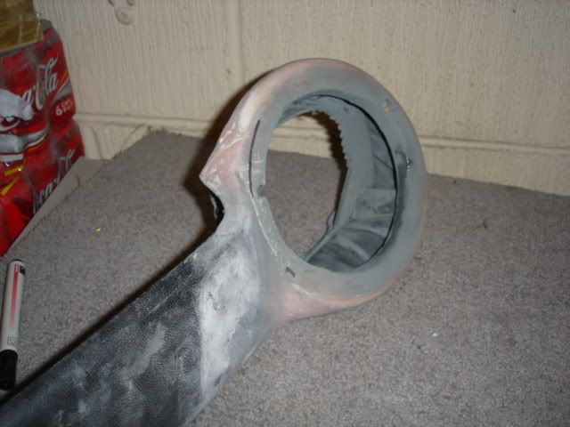

 Post subject: Re: Building door pods??
PostPosted: Wed May 20, 2009 4:56 pm
French Crew
French Crew
Posts: 1191
i've built a few pods before, and the very basics are making a few mdf rings for the speakers to sit in, then mounting them on your existing door pockets with wooden spacers to make a sort of pod skeleton(sp).
then its just a case of stretching somthing like an old sweater over them and building up the fibreglass.
once you have a few layers give it a coat of body filler, sand down and spray.
i'll have a look for some good tutorials

I have some pods identical to mouses that just need finishing off (smooth and paint/cover)
im going the mk4 interior route, youre welcome to them for some beer tokens + postage...
